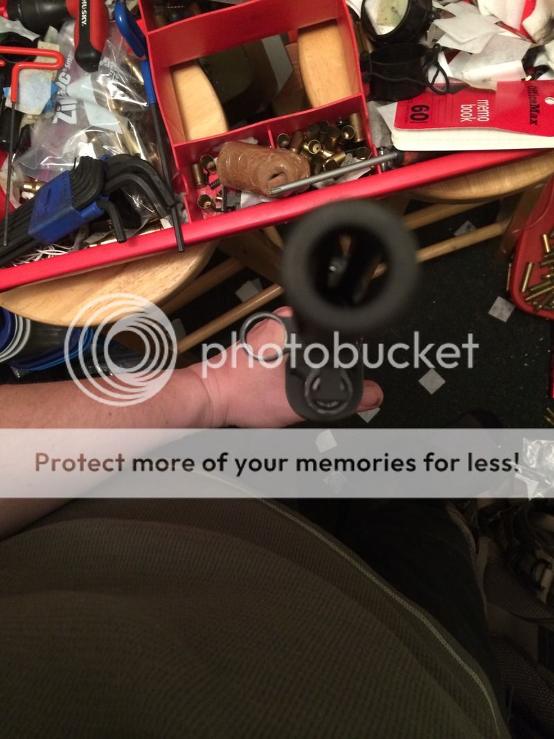

Just began the tear down to see what's going on, my last mag at the range I noticed my gas plug was coming loose after the first shot, I tightend it by hand and took another shot and it was loose again... Grabbed the wrench and snugged it up and she stayed put for the remaining 3 shots.... Hmmmm that told me something was up...
Was hoping I dident have to try to get this welded on flash hider off buuuut looks like it's dremel time, on the plus side the barrel is indexed "ok" (for a Norc) and the op rod guide looks like it's pinned properly and tight, op rod is straight and only out of alignment by 1/16" but it's leaving some rub marks on the bottom of the barrel, bolt lugs seem to be making even contact but have a bit of wear on the top of one of them....
Any ideas on the stringing? Maybe the CASM forward screw is a bit tight?
