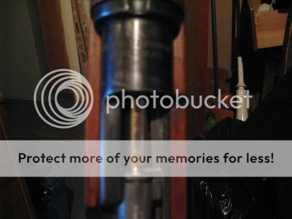

What do you guys think? Pictures are incoming.
I did. They seem fine to me. Pictures:

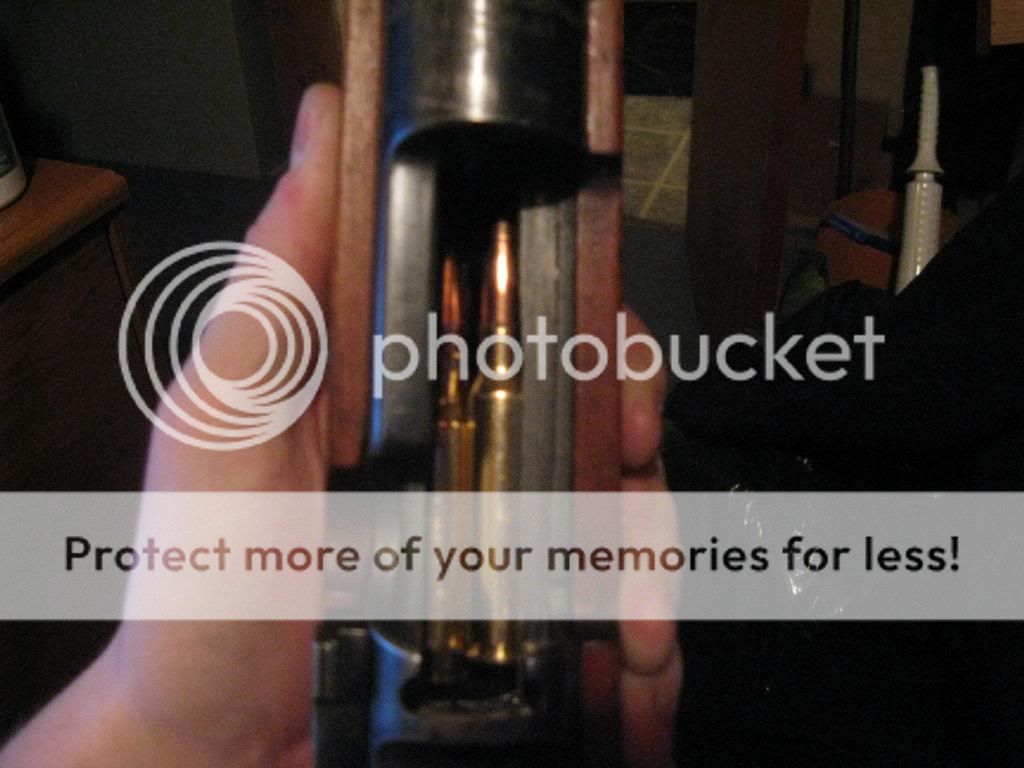

The first round:
This is where it seems to catch

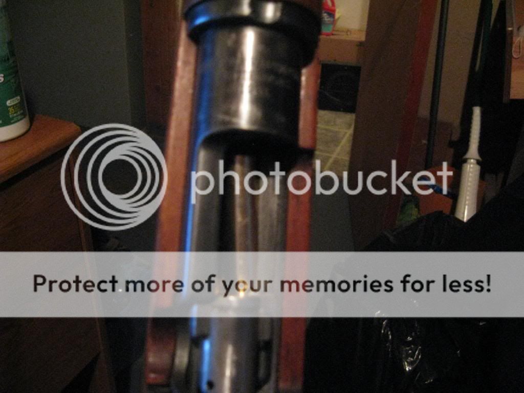

Some force gets it to begin to move under the extractor

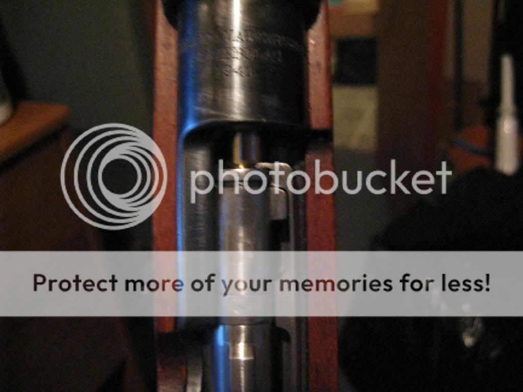

This is the point where all the rounds stop

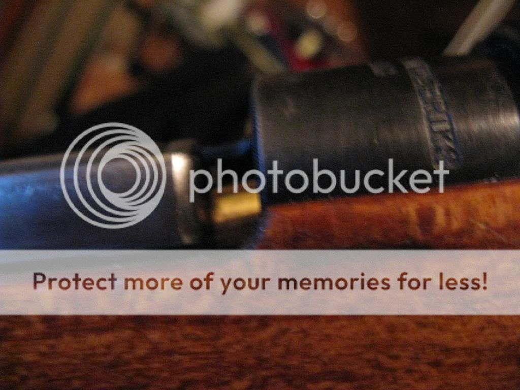

A view from the side

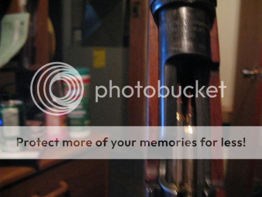

The second round

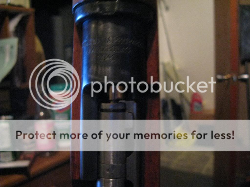

Same problem
What can you all make of this? Am I right in suspecting the extractor?

Cartridge binds on the bolt face. I took a closer look at the extractor and noticed a small chip right about the same area where the rim starts to bind. :( There's also scratches on the rim from being moved over this burr/chip. This probably explains all the issues. How should I go about fixing this? Very very fine sandpaper? Or just buy a new extractor from Trade Ex?
Take the extractor off the bolt. Take a small fine file, and file the INSIDE of the hook where the burr is 3 or 4 strokes. If the burr seems cleaned up, then assemble the extractor, and try sliding a round under it onto the bolt face. Again, for safety, take the firing pin assembly out before doing this.
If the rim drags, then disassemble and repeat 3 or 4 strokes with the file. Reassemble and try again. As long as you can clean up the burr, you should be all right. However, in cases where the bolt was really forced closed, then a new extractor would probably be better.
