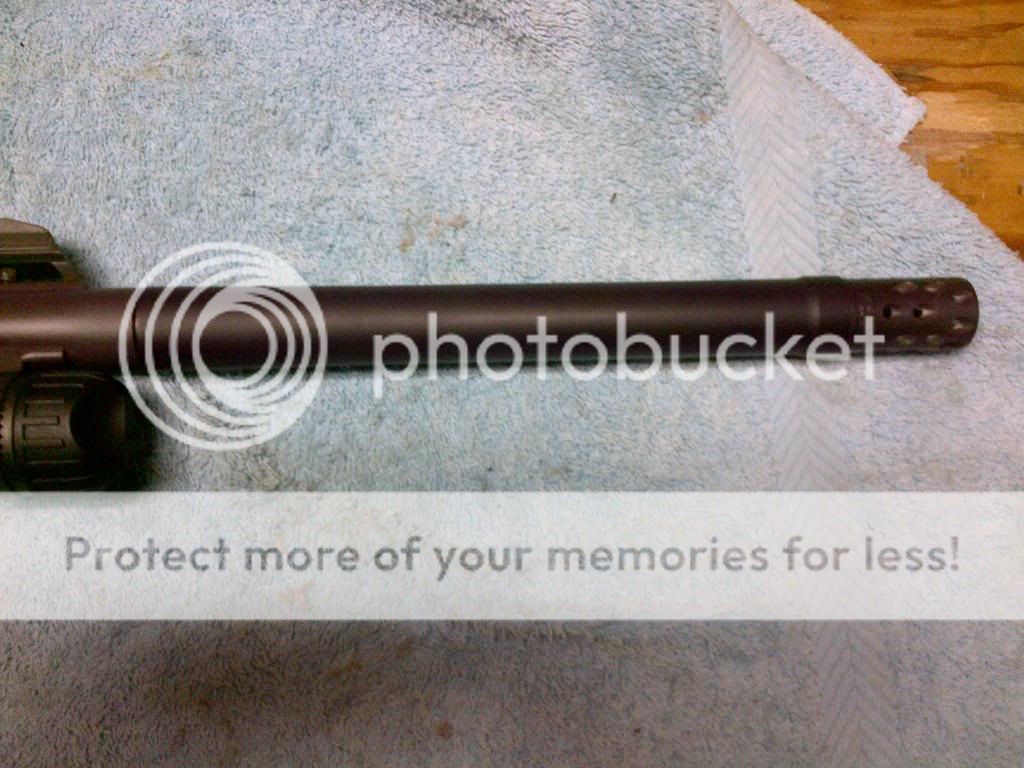

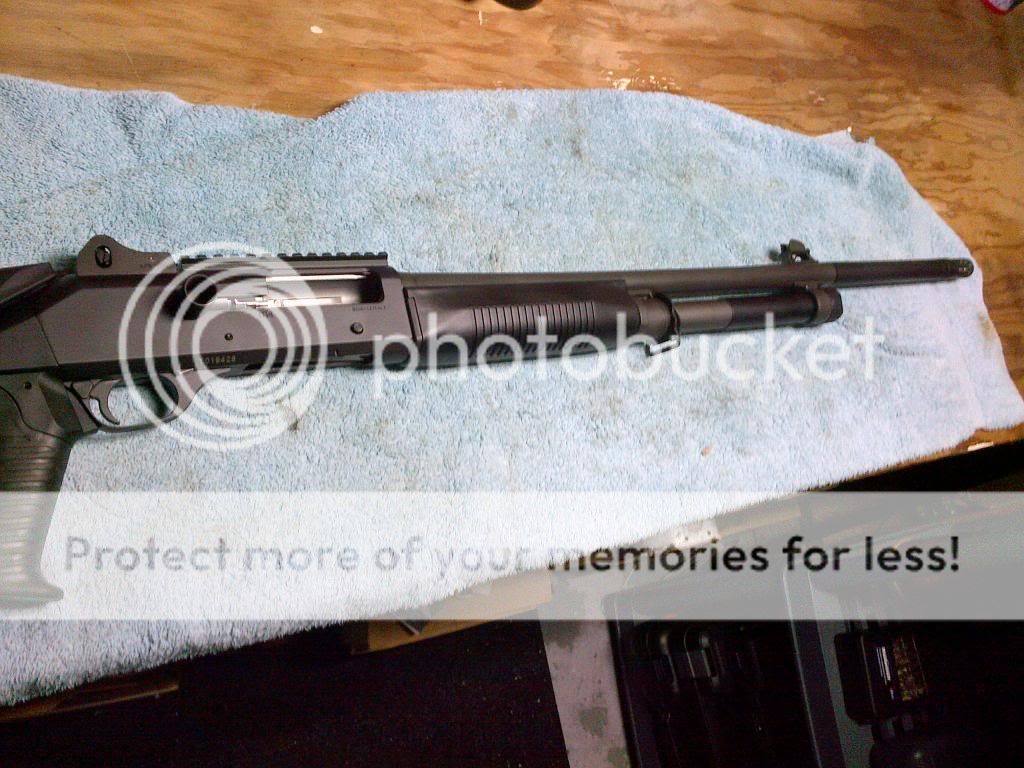

Well, here are the pics:
Once I finally got it patterned at the turkey shoot, I found it was shooting a few inches high, centered, at 40 yards. This was with #8 shot, and the turkey choke on it. I was bench-shooting while I patterned it, to further reduce the possibility of human error.
I know the turkey choke is not meant for #4's & #5's as far as loads go, but I only had a turkey choke and a modified choke for it. I left the turkey choke on to try for consistent set-up between loads. I'm going to buy a few other chokes to experiment with as the loads change.
Here's my results:
1) With 7 1/2's & 8's, no difference in the amount of pellets, one way or the other, using the extended barrel.
2) With 4's & 5's, there was an increase of about 10 pellets, consistently, using the extended barrel.
Why or why not there was an increase is beyond me, because I know an extended barrel isn't supposed to make a difference. Also, I know the turkey choke should hamper my results, but these numbers were the best with 4's & 5's we have achieved - same increases for both my gf & I, each time. The distance was only 40 yards, so I can't see the shot dropping in that distance with an 18.5" barrel - I know the velocity likely increased with the barrel extension, but it is what it is.
That's all I know; I said I'd report my results. Maybe someone with more knowledge than I can offer a better explanation.
