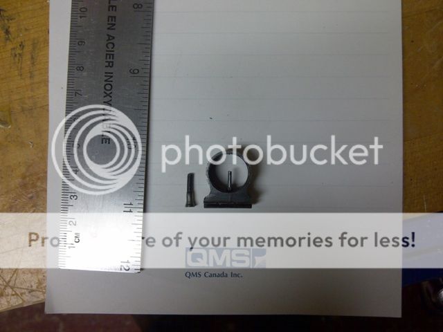

I didn't want to alter my original sight so I purchased a spare M44 sight front Liberty Tree. I removed the slightly bent sight post from the one I received and started thinking and measuring. Without making any changes to the sight block itself I spent about 0.18 on a 2 mm spring pin. I choose 2mm for it's OD size compared to the original sight and it's ID accepts a small nail with some carefull persuasion.
Now with that you need a small nail, say from that pile of picture hanging stuff everyone has somewhere and a dremel will certainly help. The spring pin is cut to length about 5/16" to 3/8", the nail is cut to length (edit I left the head on and just made sure it would sit flush with the bottom of the sight), tap it into the spring pin then tap the nail and pin into the sight base from the bottom until flush. It fits in pretty snug so I suspect it shouldn't vibrate up especially since the hole in the sight block tpaer down as you go up.
The nail is filed down just like the $15 tall pin on eBay. Paint the nail black and your done. I have to field test to make sure it won't vibrate out but it will be fun testing. It's in there pretty solid but some epoxy, thread lock or equivalent could help solidify the post. Once you have filed the post for elevation you can dab on some regular flat black paint or nail polish to protect the top.

Pic 1 the basic components with before and after comparisons. Final post has the nail head left on. I haven't updated the pics.

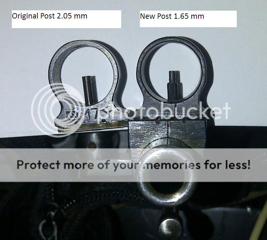

Pic 2 the nail and spring pin assembled.
Pic 3 the assembled components which I painted afterwards with VHT Flameproof flat black.
The spring and pin can be tapped out if you want to put in the original post. If you file the nail down too far, get another nail. I am making a couple of extra post assemblies and will pre paint them.
I will soon be out to the range to test my new post and make the adjustments to post height. I left it a little long so I can file down the post to bring the POI up. Also just from viewing the sight picture, the nail is narrower than the original post. Old post about 2 mm the new post is about 1.5mm
