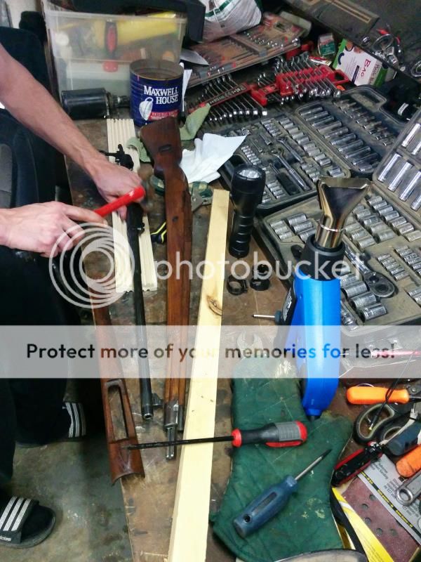

Had a even worse problem (mine wouldn't come off), used a heat gun and tapped it with a hammer and punch. Took it over to a buddy's house and two sets of hands really helped. Heat the f@cker up and you shouldn't have a problem.
