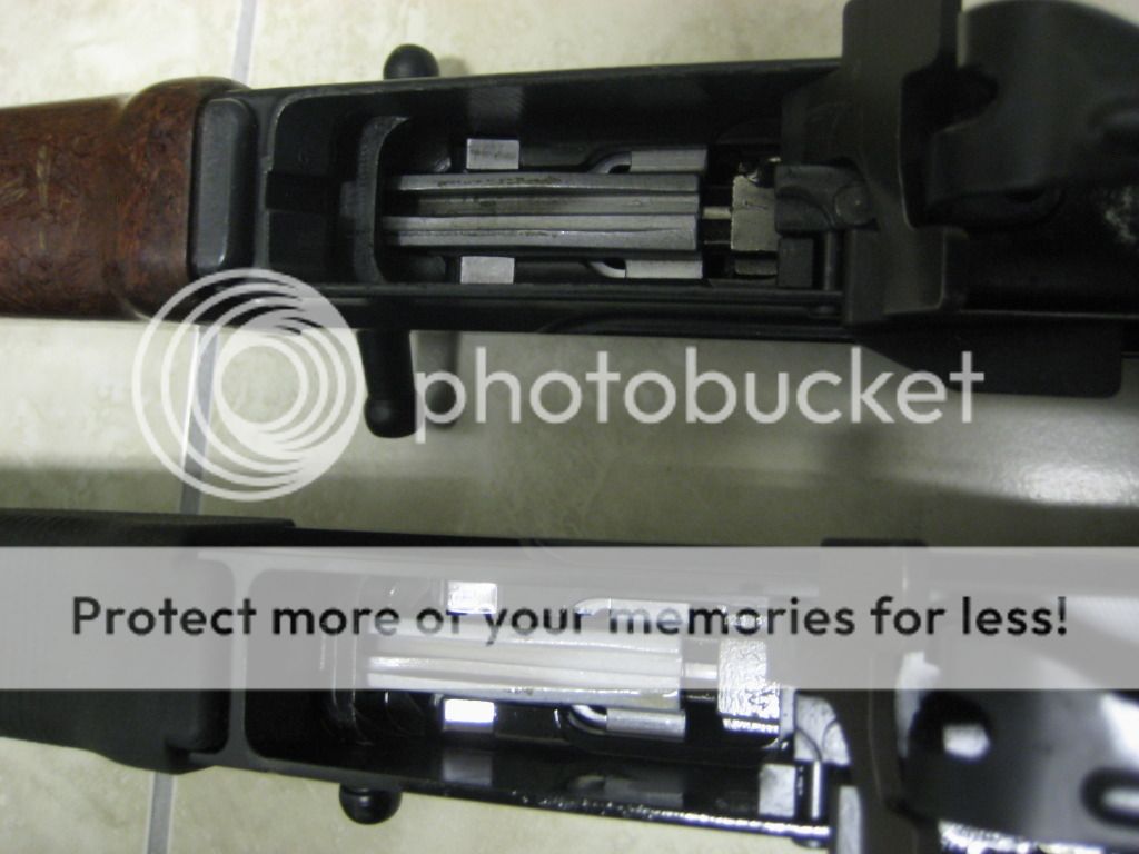

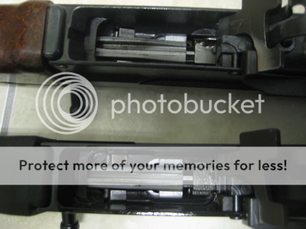

As the title of the thread states, I have tried all my VZ-58/CZ-858 mags in a new CSA VZ-58.
Will not fit at all. I know some mags can fit differently than others, but this isn't it. They just can't get past the mag catch. Fit fine on my VZ-58, but not the CSA.
Any ideas on how to remedy this?
Here's a pic of the two side by side if that helps. (CSA on right, regular VZ on left)
Here's another, still kind of cr@p, so I'll try again with a better camera.
The only difference I see is that the regular VZ has a deeper cut at the fron of the magwell.
The cut in the front of the mag well on the CSA is different than the CZ858. Not sure if it has something to do with the ambi safety but my mags required removing some paint off to fit.
About 3/4 of my mags wouldn't latch up properly in my CSA. I removed material from the face of the mag catch and that fixed it.
Do your mags fit any better with the OEM mag catch installed?

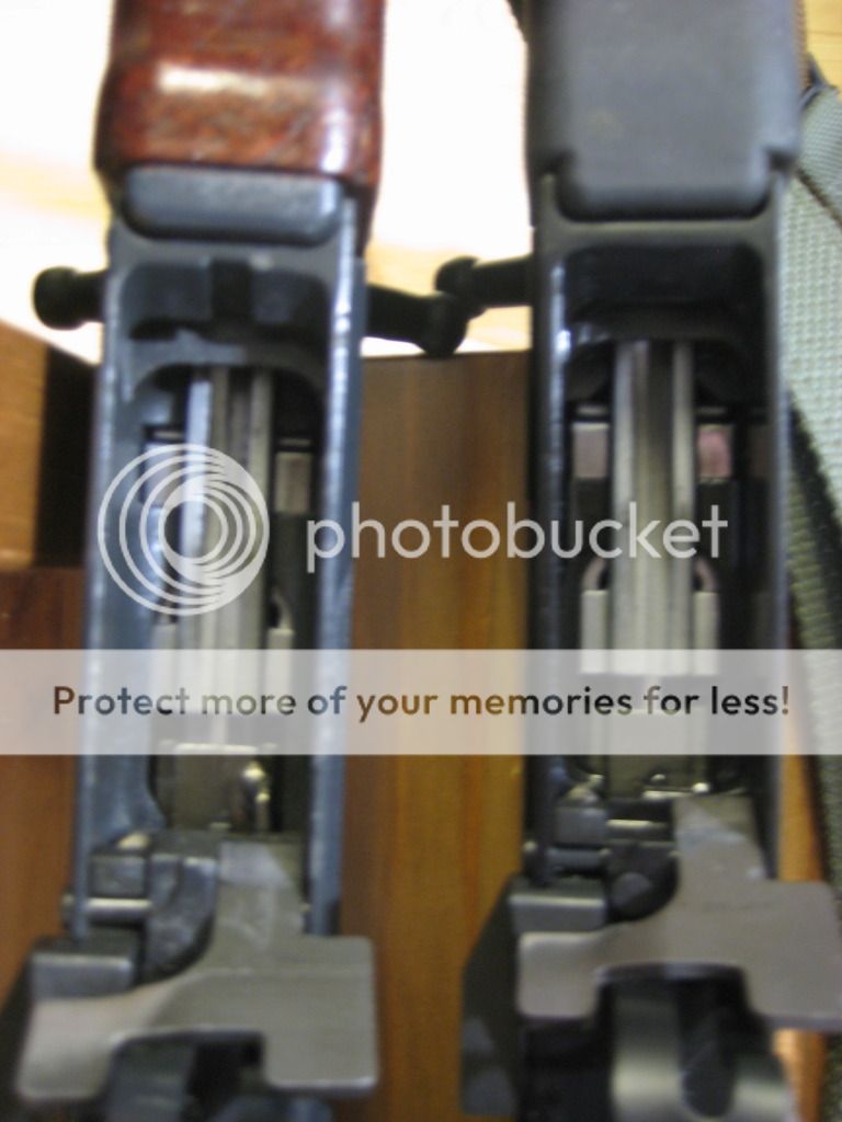

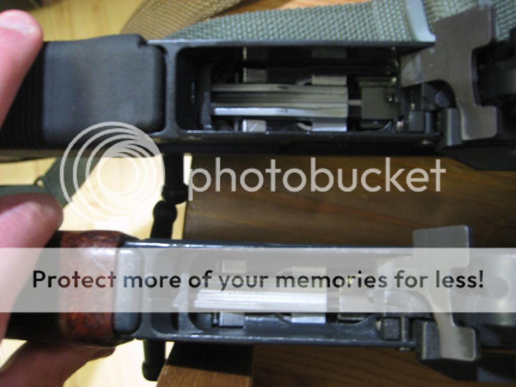

Thiis happened on my CSA it would not take most of my mags.. Take the bolt carrier and dust cover out , then try to put the mag in a bare receiver , if it seats fine then most likely its your bolt carrier tab stopping the mag from fully seating you might have to file a bit off the front edge of the tab.. If the mag wont go in the bare field striped receiver then you should be able to see where the mag contacting easy , sometimes the front face of the ejector post in the receiver must be filed down a bit for the mag to fit in fully , this is what was wrong with my CSA i filed the Ejector face a tiny bit now all mags work ..
Not sure what the problem would be. The cutout in the front of my CSA 7.62 magwell is different from that of the 858 and other 58's I've owned. Mine looks pretty much the same as yours, and works fine. I even have the same aftermarket ambi mag release...

I think it is the magazine. Just cause they fit without issue in your cz858 doesn't mean they will fit in your CSA. The mag well in the CSA is tighter which is why everyone had to remove some of the paint or file some area's on the magazine if it wasn't seating.
