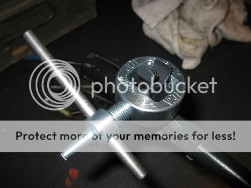

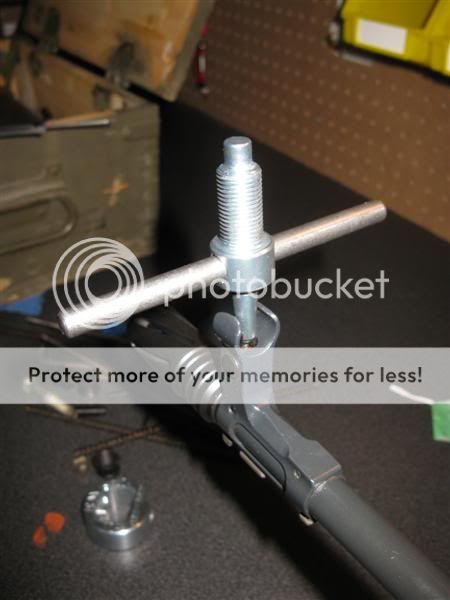

Here's a few pics I took tonight of the best front sight tool you can buy. I purchased it out of the US before Neit Arms began to import them.
The handle will stand up on the front sight post for adjusting elevation or installing/removing the sight. It also works with the NEA fibre optic sight post.
The last time I adjusted the windage on my VZ it was with a c-clamp, a door hinge and a piece of wood. This is much nicer!

I need to remove the 'guts' from one front sight and install them in another.
Will this tool allow me to do this?
What do you mean by "guts"? The windage drum that the front sight screws into?
I don't think the tool has enough throw to push the drum all the way through, but it will get it started and just use a brass punch and a hammer to finish.
