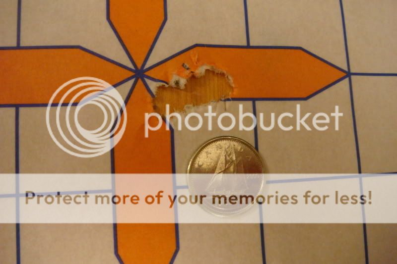

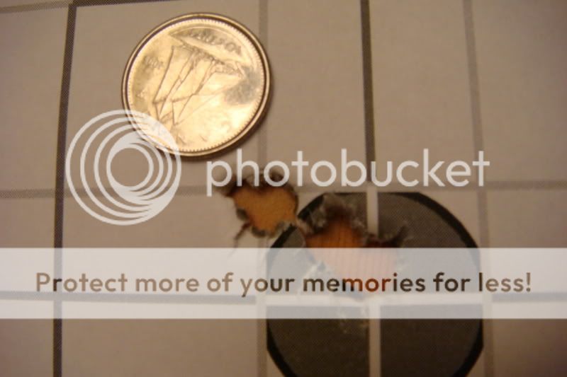

I beg to differ. I am starting to load my 7WSM and after 20+ rounds downrange, I have no issues using CCI 200LR primers. Groups are nothing to write home to for many precision shooters here, but for me it's plenty good.
100 yard, 3 shots, 62gr H4831sc, 168gr SMK, Win brass, CCI 200LR primer, COAL 2.860".
67gr H4831sc, 140gr Partition, same stuff.
