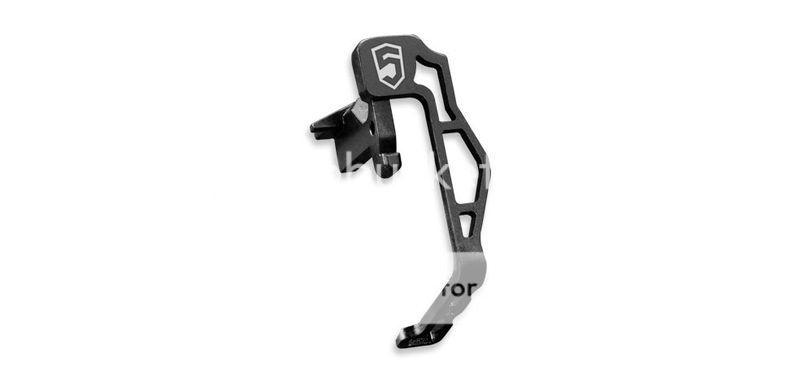

I have one of those phase 5 levers ...I didn't like mine as I had to file down the existing lever on my NEA to get it to fit. I believe this was due to the NEA upper being shaped a bit different.
As well it kept coming loose even with locktite so its in the parts bin.
Phase 5 makes another one that doesn't bolt onto the existing lever as its a one piece design (much better) and it replaces the existing lever.
EBVR2
Thanks for the tip. I will knock the Phase 5 Tactical Extended Bolt Release V1 off my list of things to try instead of the Bad lever. Is it difficult to install?
