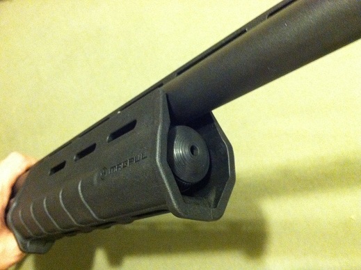

Have any of you guys put a Magpul fore end on a 12.5 inch gun? I'm concerned the fore end will stick out past the end of the barrel as the pictures seem to show the barrel nut recessed a bit in the fore end. I have an older 870 Wingmaster that I run with a 12.5" barrel I bought from Can-Am. I'm thinking of throwing on a polymer stock set and I like the look of the Magpul stuff. Think there would be any issues?
This picture shows what I'm concerned about:
It will be fine. It will get blacker but that is about it.
The main problem is that you will have an ugly gun with that furniture on it ;)
Yeah I was wondering about that too, but in the tactical shotty's thread there are a bunch on 12.5"'s so I assumed, it would just get filthy.
I put the magpul on my 12.5 had to put a smiley face end cap to replace the sling so it would fit. It is so much fun to shoot, and yes the the forend gets a little dirty when you shoot it.

Unfortunately that particular MOE for end extends too far forward for a conventional forward side sling plate.
