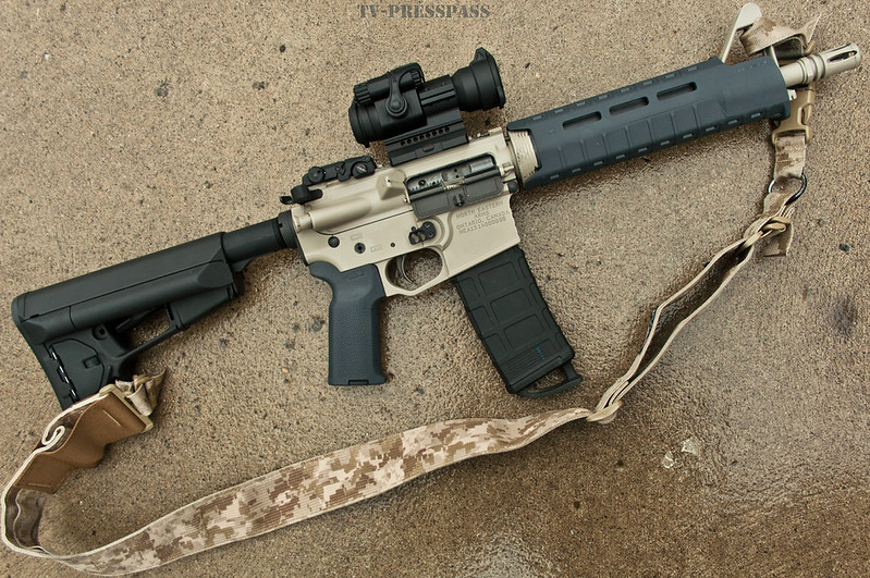

Just a heads up, this did not fit on my 10.5 CQA.
I tried clearancing a few areas to no avail. It felt like the heatshield was too narrow, so I removed it - even without the heat shield I could not get it to snap in place.
My theory is that the barrel is too large in diameter for this slimmer handguard.
If someone successfully mounts one on a Norinco I'd love to hear how. I'm usually successful in fitting parts.
Otherwise consider yourself warned.
