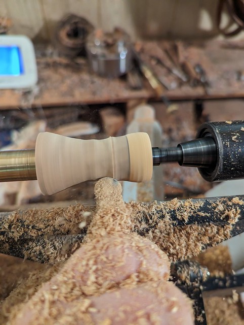

From there it's chucked on the lathe, squared off and rounded down to start to make the shape. seldom do i have more than just a rough idea what shape is wanted. I just put carbide to wood and stop when I feel is right.

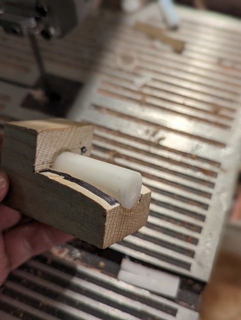

A piece of pre drilled delrin is inserted into my high tech jig to be cut on the bandsaw
https://flic.kr/p/2o1T9cE by https://www.flickr.com/photos/185799180@N08/, on Flickr

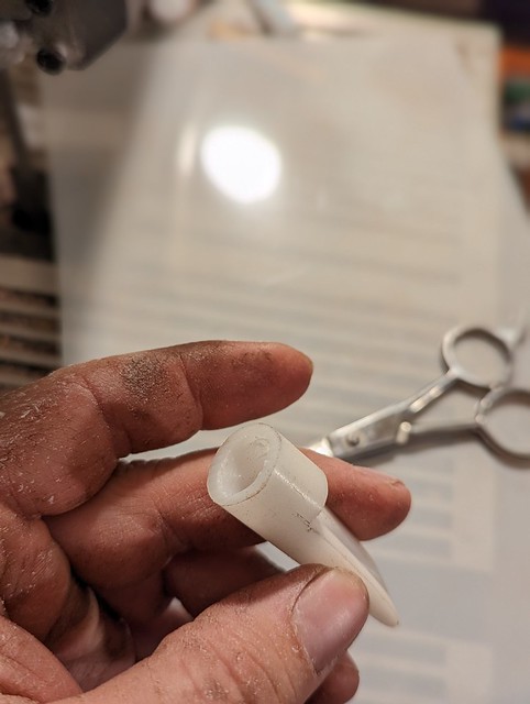

For obvious reasons it's cut slightly oversized and then comes the slow process of hand filing the toneboard to it's final shape
https://flic.kr/p/2o1Th6a by https://www.flickr.com/photos/185799180@N08/, on Flickr
