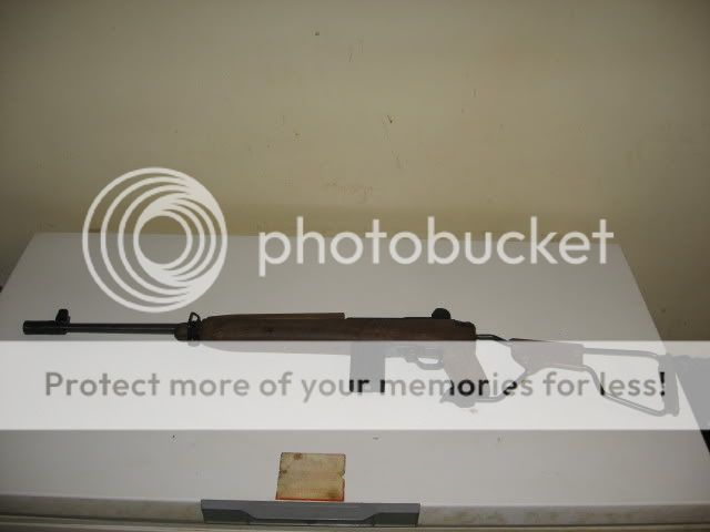

purchaced on the EE recently by myself. guy i purchaced from did not do the conversion.but whomever did , did an ok job. chicago kit is next. going to mount a standard 10-22 mag to a real thompson stick mag i got at a show this weekend to finish it up. wish i could find the green mountain barrel that has the fins like the old tommy guns.

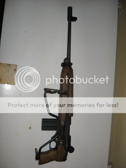

I asked Skirsons about his viz-modded 10/22, and he told me this:
skirsons said:
It's not too hard. You need to remove a little wood from the sides with a dremel and from the opening at the bottom. You also need to add wood into the channel that holds the M1 Carbine return piston. I did it in a few hours so it's not a difficult project. Getting theupper handguard to fit requires a scope rail turned backwards and cut short just long enough so it holds the rear of the handguard in place.
You can see it in this pic:
-Steve

Before I put on an aftermarket stock (changing the rifles over-all appearance) mine looked quite a bit like an M-1, just by adding a muzzle brake and tech-sights (basically what the rifle above has got).
that is one really nice conversion! I love M1 Carbines but do not want a restricted rifles because I hate being limited to shoot it only at ranges... (I know there are non restricted ones but havent been able to find one yet that I like)
Thats exactly what I did, except I like the look of the 10 round mag better, still not straight, but better proportions.
