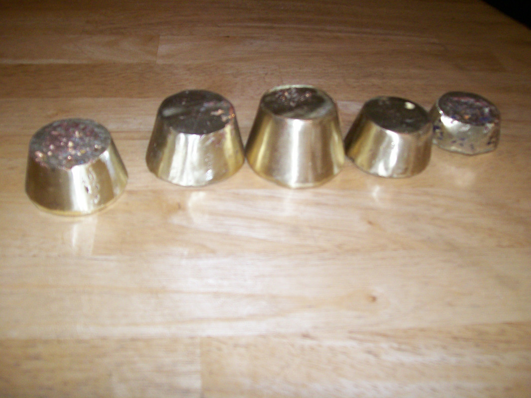

My buddy melts metals down and makes knives & such.
I gave him a bucket of" fired" 22 bras that I had for a few years.
When they got melted, they popped and threw hot metal all over his shop ! Those empty 22 bras are Nasty even when fired. seems like there's always something left in them.
he made me these ingots out of the 22 brass
lone ranger - is it possible there might have been a drop or two of moisture in any of those brass? When I started to melt wheel weights, I was benefactor of several visits from "tinsel fairy" - being dumber than a normal hammer, it took several occurrences before I realized that some wheel weights might have been wet at one time - towards the bottom of 5 gallon bucket, that no doubt had spent time outdoors - still contained drops of water - and I was dumping them directly into molten lead - water immediately turned to steam and propelled molten lead all over - onto my glasses and shirt, some on my cheek, onto my welding gloves. I never tried to melt brass, but would suspect same phenomenon could occur? Is hard to imagine there is any live primer compound left after successfully firing a round, but your buddy experienced what he experienced.
Oh boy... good point.
ya , you bet there could have been moisture in them.
I never thought of that. Very possible.
