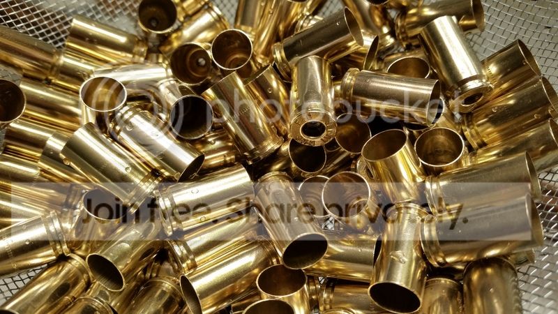

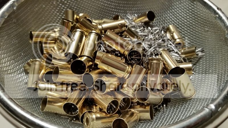

My tumbler also does not have any paddles on the inside. Here is what i add to my tumbler and the results;
1 lb stainless pins
brass casings
1 small drop of dawn dish soap
1/8 tsp lemi shine (citric acid)
Hot water to just above the brass
The bellow pics are from only 2 hrs of tumbling, I believe the Lemi shine is the key ingredient.
