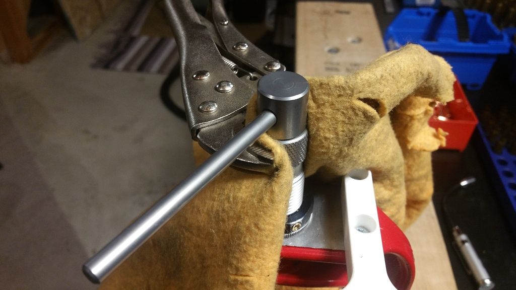

Collet style bullet puller. I use RCBS collet bullet puller, with a 30 cal collet. (bought from amazon)

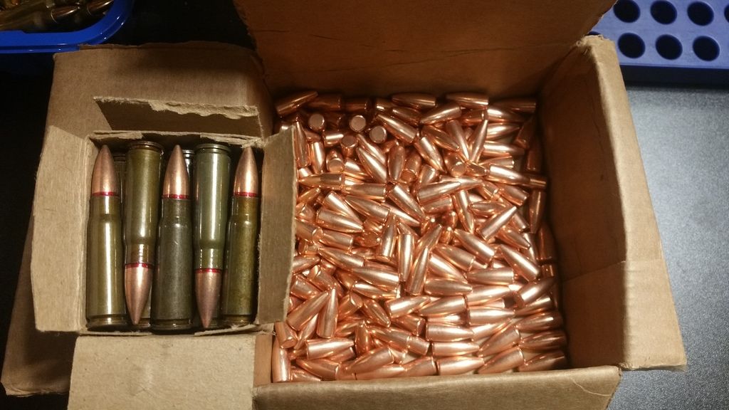

Some cheap 7.62x39 surplus ammo - I use Russian.
Some non-magnetic 7.63x39 projectiles - I use Berry's .310 123 Gr plated SP projectile.

How the puller work: The handle threads into the collet through the body. When spinning the handle clockwise, the collet is pulled into the body by the threads. The body forces the collet to close and grab the projectiles.
Install the puller onto the press
Raise the ram with a cartridge on the shell plate
Tighten the collet by spinning the handle clockwise
Lower the ram. Voila! Projectile is separated from the case. There's nearly no damage on the projectile, so it can be saved for later.

Projectiles compared:

Surplus rounds are around $0.23/round delivered to the door these days. I got mine when they were $0.20/rd delivered
I use Berry's plated .310 SP projectile. My last batch from Marstar cost me $406.20 for 2000cnt delivered to the door during thanksgiving sale. ($0.203/projectile).
Previous batch was from Custom Reloading Service in BC. Cost me $135.52 for 500 cnt delivered to the door. ($0.27/projectile)

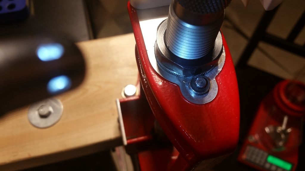

If I were to buy the puller again, I'd probably buy the Hornady cam-lock bullet puller. Problem with the RCBS puller is that when you turn the handle to tighten the collet, you might end up 1. spin the puller inside the quick change sleeve, or 2. spin the quick change sleeve against some locking pin on the press. First case it won't tighten the collet, second case it might damage the press. Hornady's system work by pressing down a cam to lock the collet. I think it would work far better.
See how turning the handle on RCBS puller can cause potential damage to the press:
It also makes it very hard to spin the puller out later on:
