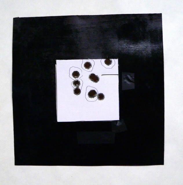

Here is a target from 100 metres, first five gas checked shot, then marked and then five plain base shot. They all had the same charge, which was 45 grains of 4895, a load considerably higher than factory loads. Just luck, but the plain base made the best group.
