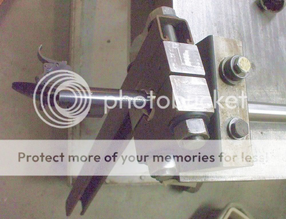

For an action wrench I am thinking of something along these lines. So, my order for the metal place will be about 4 feet of heavy duty 1"X1".
To not reinvent the wheel, it would look something like this one:
^This pic is what I am thinking the finished product might be.
with the 336 I am thinking I could get away with no cutouts as it's a flat sided receiver, except for the oval end up front.

The wrench you show on that 700 clamps the receiver more tightly on the threads. It is a terrible design. It is also only for round receivers. I use an internal wrench on 700's that engages the flats of the race way immediately behind the lug recesses.
For flat sided receivers I use a wrench that clamps on the flat sides of the action. Usually 30-30 levers actions barrels are not that tight.
I was not going to make hemispherical cuts as I have a 336 not a 700. The picture was for rough reference only. :) Nice wrench you have there. :) There is a lot of flat surface area on the 336 receiver to spread out the pressure.
I am guessing it might be a good idea to turn a rod to fit snugly in the receiver with a hand press fit to support the inside of the receiver.
I made my flat sided receiver wrench from two pieces of 1x1 stock. Turn one end of each round for pipe handles. Two 1/2" Allen head clamping bolts. Use copper shims to protect the receiver finish. Sort of like a big tap wrench.
