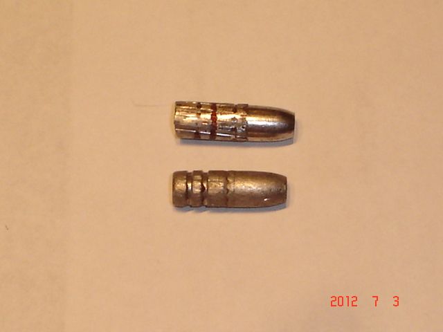

Yes the whole slugging thing is a good idea, but as I found out, if you do not expand the neck, the result will be an undersized bullet from shaving. The bottom bullet was shot out of a Henry rifled barrel. I found it on the ground where it tumbled and skipped off the turf. The top bullet was a slugged through a Marlin barrel. Both are .309' in diameter. Both barrels were brand new. The bullet now shoots very well out of my Marlin 336W (micro-grooved barrel) now that I expand the neck size.
I now use a .310 (gas checked) bullet from a fellow gun nutter which shoots more accurately with the lighter load and heavier loads.
