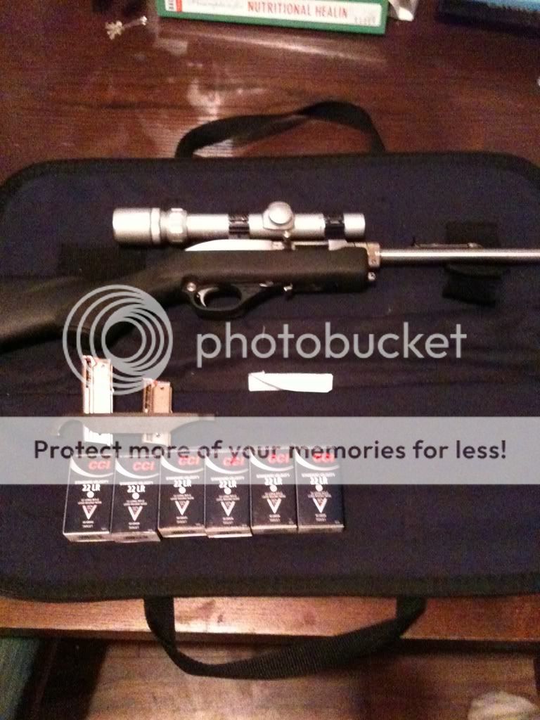

My 70pss only has about 400 rds of CCI std vel through it but not one jam, and accuracy is exactly on par with my model 60. The case is nice to store ammo in also, im thinking of testing to see how much weight it will float because there is enough room in the case for several boxes of ammo, a couple mags, cleaning kit/tools, basic hunting trapping and fishing supplies. A SHTF bug out case dedicated to food gathering and basic survival needs. Personally i leave mine assembled and plan to only pack it up for camping and fishing trips.
mine wears a 4x bushnell banner that fits nicely in the case.

It won't stow in the case assembled, the barrel comes off and stores in a sleeve in the case. OAL assembled is 35.25" and weight is 3.25lbs. And the trigger is polymer. that is the one thing i ill be replacing next time i visit my parents in the US is the trigger guard. there is a company in the states that makes really nice aftermarket marlin parts but they dont ship to Canada.
As a plus though, one thing i was really not expecting was that the scope stays perfectly zeroed at 50m after i remove and reinstall the barrel. it looks like it has been lapped for a really nice fit... i thought for sure i would need to re-zero everytime i mounted the barrel.
