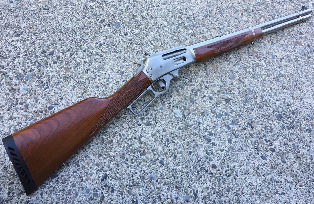

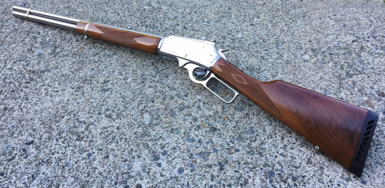

I've thought along similar lines myself . I think I'll just pick up a pistol gripped 336 in 30/30 and switch the trigger group , lever and butt-stock . Hopefully , a minimum of fitting will be required . I like straight gripped lever guns , but in 45/70 it can get old quickly when shooting heavier loads . In 30/30 , it should make for a very pointy little rig .
Nice looking little rig GMC403! I was aware of the difference between the levers, I didn't think it would be too challenging to mill a relief for the 45/70 rim(I've been surprised before though). What did you do with the conversions you have done? Or were you mostly working on the 336 platform?
