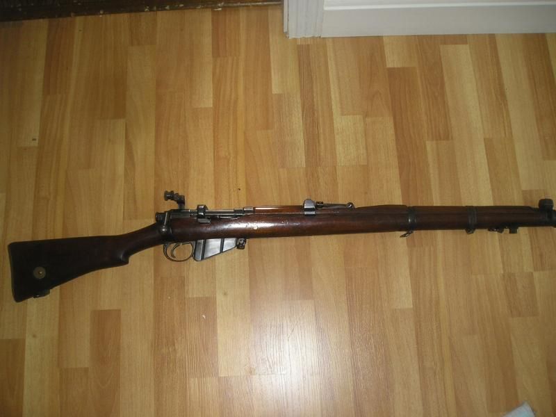

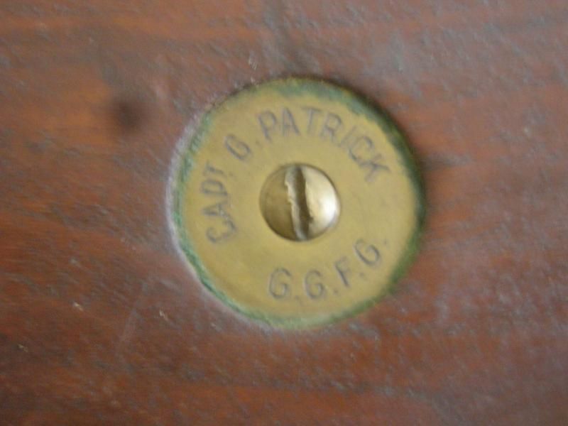

Here is a pic of martin adjusted SMLE.It was owned by a Lt Col G patrick.His name is on the butt disk.
I was told he won the governor gererals shooting match in 1934 with this rifle.
Is there a list of winners of this match somewhere so I can confirm it???
Any info??

GGFG is Governor Generals Foot Guards. A good place to start for information on the original owner. The Nominal Rolls and Diaries should be available.
Captain George Patrick was one of the four Officers who was on the Guard attending the body of Lord Tweedsmuir on February 12, 1940, as it lay in State in Ottawa.

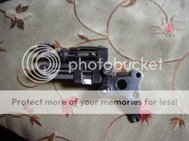

Here is my "Martin Adjusted" No 1 Mk III*. This one was made by National Rifle Factory (NRF) and later modified for target use. It has the aforementioned hose clamp around the wood between the middle band and nosecap. The barrel is a BSA commercially made model. It shoots fantastic.
Here is a photo of the sight that came with it. The plastic labels were on the rifle when I bought it, and since the same type of labels were on the DCRA No 4 that came with it, I didn't want to take them off.
