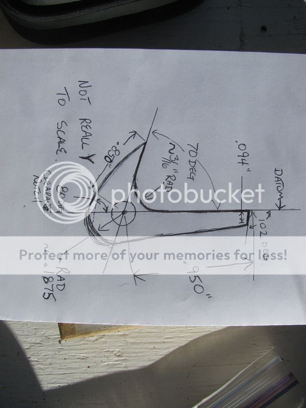

I'd appreciate that, if I had some dimensions and photos to go by I'm pretty sure I could make one up. I'm going to school for machining so I have access to lathes and mills

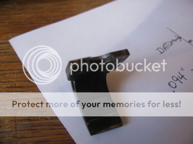

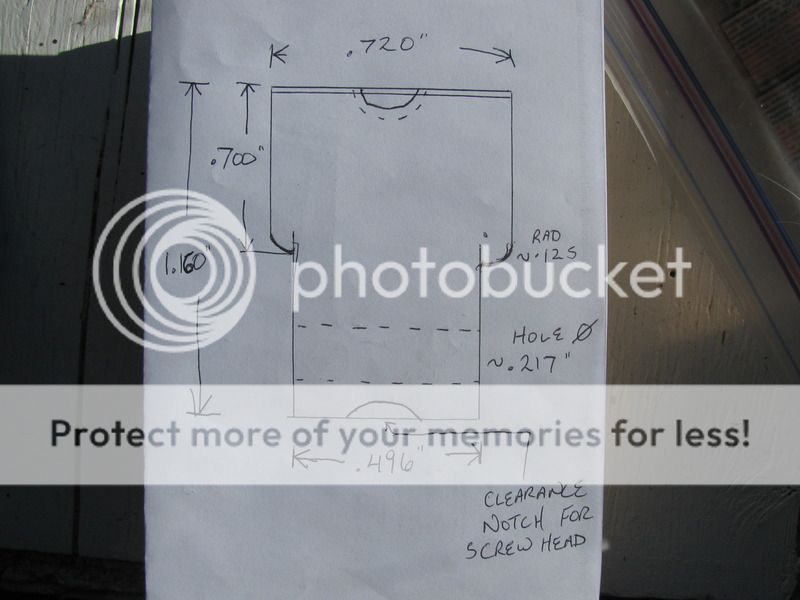

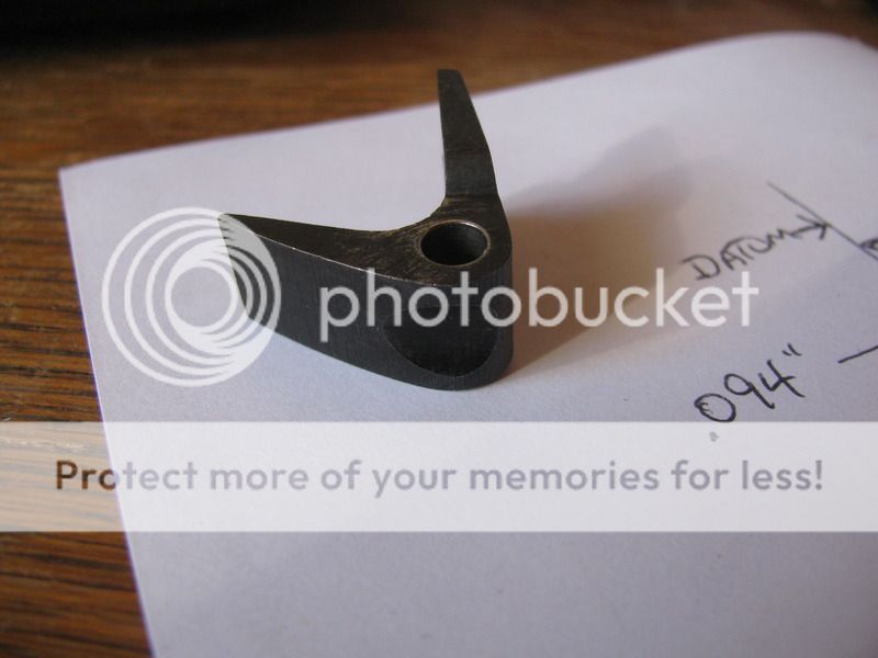

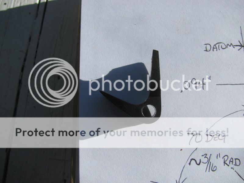

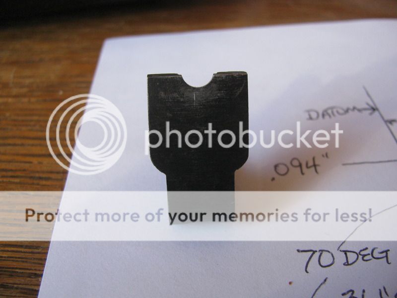

As promised.
The drawings are a bit cluttered, but I think you should be able to work it out.
Forgot one dimension. The sharp end of the rear of the extractor is about .025 thick, not a sharp point.

Check the hole diameter against your cross pin, or the pin hole for same.
Other than that it's pretty straightforward. I was surprised that the relative geometry all fell in place like it did. The flat surfaces of the two planes intersecting at the centerline of the pin hole is really convenient!
Almost as if it had been designed that way... :)
