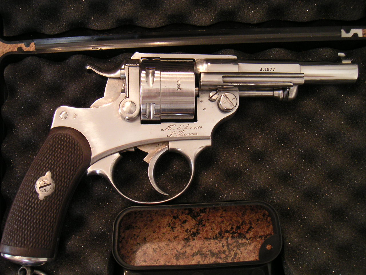

I figured that it would be useful to start a thread on this revolver.So people could share and ask questions.
My question is how do you feed them? What are options here? Rechamber? Reload? Where do you get reloading supplies?
My 1873 commercial MAS is already a 45 auto cal model according to the FRT. It shoots 455 Webley MKII large and small primer brass perfectly! Even 455 Colt and 455 Eley. Fun to shoot.
