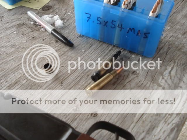

Well, I think the 40g of IMR 4064 with the 168 fmjbthp worked the best.
I had two case separations though....
On the up side, a 303 broken case extractor worked on the 7.5 case for me.
I made my brass from 6.5x55 swede. Upon closer exam by a shooting bud at EOHC, we noted the bottom of the cases all had a nice swell to them. I think I may have to re-think the brass for this one.
Anyhow, the new rear sight is good windage-wise. For elevation, I suspect my loads will be about four inches low at 100 yards but I can raise the rear sight up for that.
