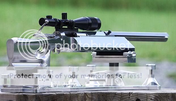

Here is another one. This rifle weighs 70 lbs and some go well over 100.. Do very heavy barrels assist accuracy? You bet - SIZE DOES MATTER. This stock was carved from solid aluminium.
Yes! That's the kind of thing I'm talking about. Though, I never would have thought any actually existed. Well I guess that answers my question.
Thinking about it though, it seems those kinds of rifles would eliminate a great deal of the human element of shooting. Besides reading a little wind, there's not much to do. It's almost like an engineering contest or something.
