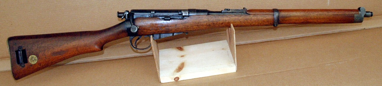

Does anyone here have any experience trying to match up different shades of walnut. Just trying to see if i cant match up some wood on a SMLE. Any help is much appreciated.
Take the darkest piece and stain the remaining pieces until they match. Each piece will take different amounts a stain to match up.
The color can be bleached out of walnut. Sometimes, the best approach is to bleach the color out of darker or off-color pieces and then stain to match the color of the primary wood. I have done that several times to get black walnut to match the original wood on restoration projects. Hydrogen peroxide and a lye solution are the active ingredients and the bleaching kits are, or were, commercially available. Due care is required for safety.
All of the wood between the mid and upper bands started as quite dark black walnut with appropriate grain. The color of the original wood has not been altered - just oiled with linseed.
Im having trouble with a few spots on a restoration project. It has had linseed oil applied already, and I'm not too sure how to get color though the oil, or if I can. As for the purists, its a restored sporter anyways.
Linseed oil can be tinted, and you could try thinning it with turpentine and tinting it. Thinning it would improve the penetration.
I doubt even the purists would object to restoring a sported milsurp.
Oh the horror!
All the milsurp purists will chime in soon and you will get it.
