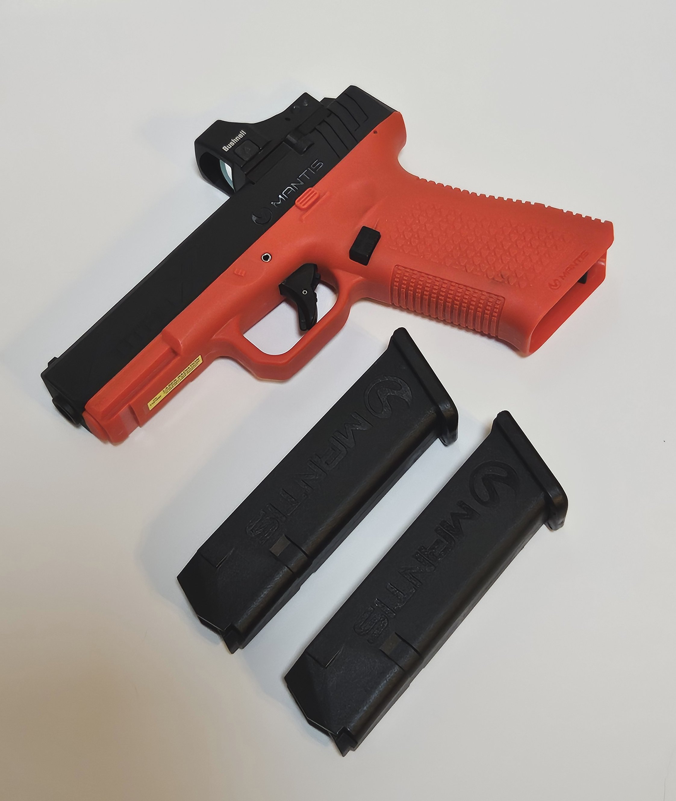

When Mantis offered me a TitanX to evaluate free of charge, I jumped at the chance. I’ve wanted this type of training tool for a while now. However, no affordable laser solutions were available that felt and handled like a common production pistol. I received the medium size version of the TitanX that is similar in size that proportions to a Glock 45. I say similar because it isn’t identical. There are some differences in geometry, notably the ejection port shape and the front of the trigger guard. More on that later!

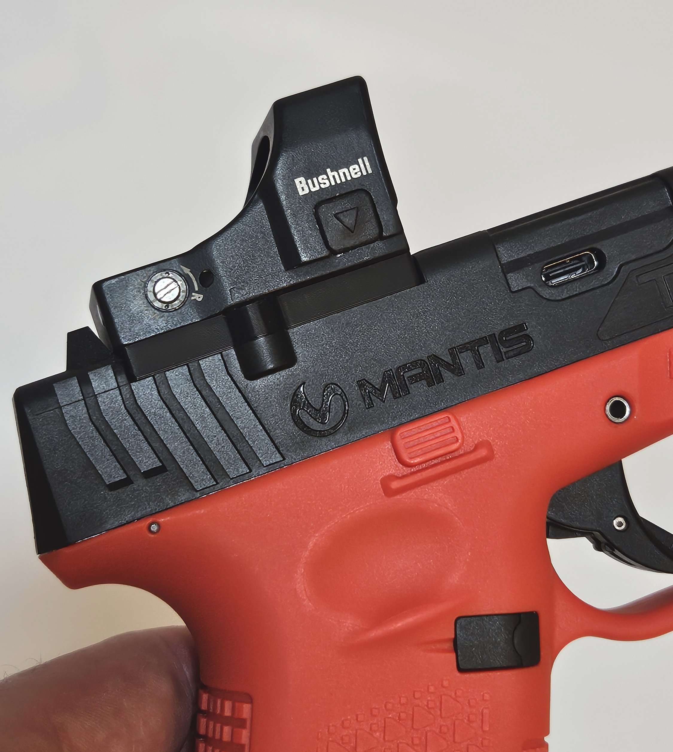

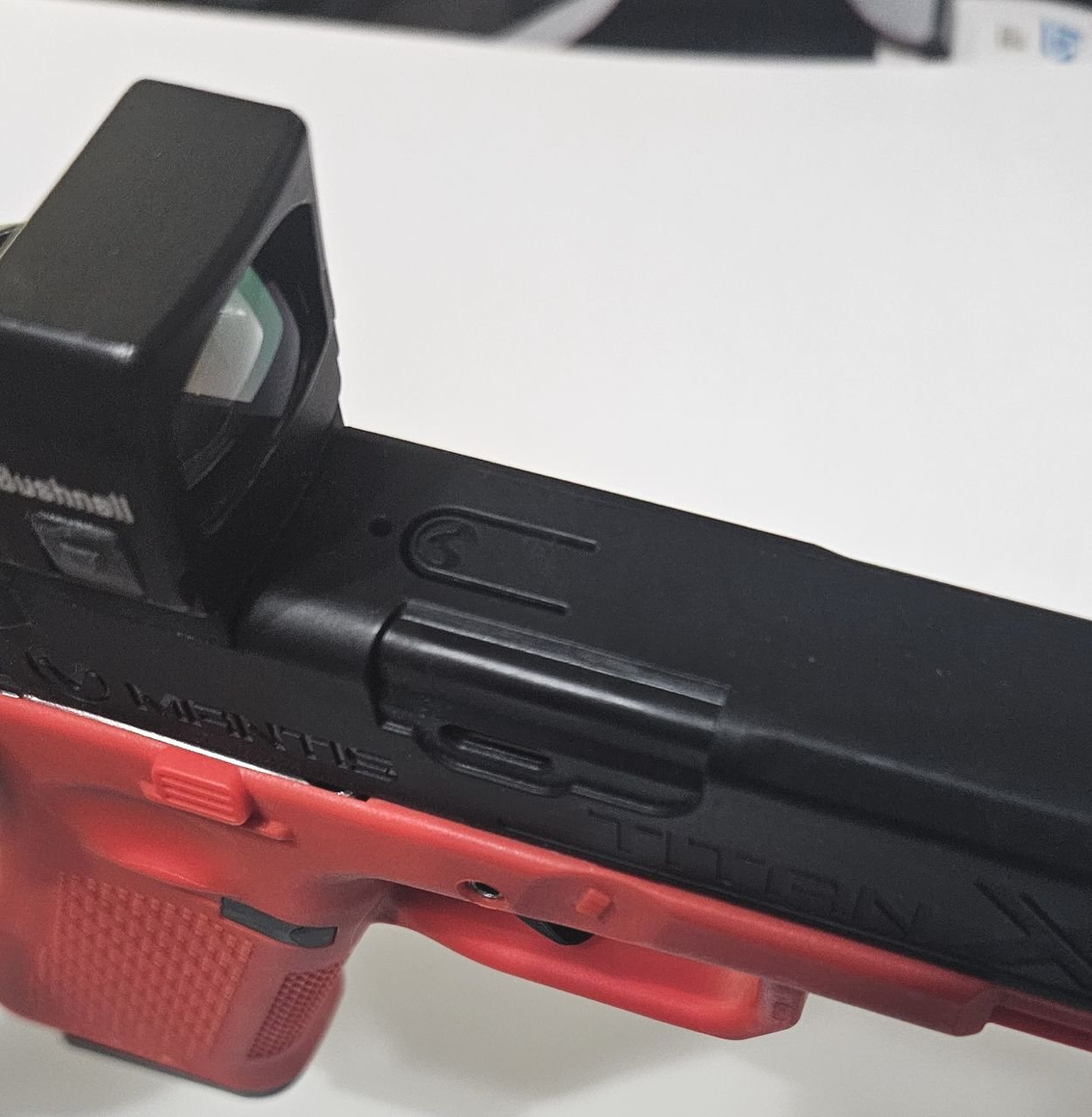

The TitanX is a stand-alone laser pistol, colored orange to distinguish it as a training tool, that is capable of mounting a red dot sight and pistol mounted light. It has weighted dummy magazines that let you practice magazine changes as well, without the need to hold the slide stop down. This also gives the TitanX a more realistic feel when handling it. The magazine release is reversible like the one on a real Glock pistol. The optics cut is designed to accept optics with RMR and Sheild RMS/RMSc footprints. Like the Blackbeard, TitanX has screws to let you adjust the laser to match your point-of-impact at the same distance your sight is zeroed at. The pistol has an internal battery that recharges thru a USB-C port on the side of the slide.
Custom TitanX 3D Printed SPP Adapter Plate
I had a cheap red dot with a Delta Point Pro footprint laying around that wasn’t being used on anything. So, I whipped-up an adapter plate for it which I 3D printed. Since there isn’t any recoil, I didn’t see this being an issue. Mantis has the drawing of the optics cutout in their manual, so designing an adapter plate was quick and easy.

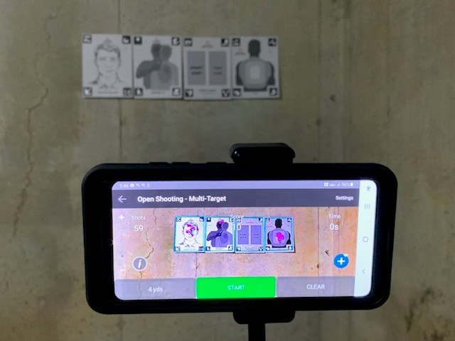

I sighted in my TitanX and tried it with the Mantis phone app. All of the great training routines with motion sensor feedback and motion tacking worked as expected. I’m not going to go into detail about these as they will be covered by the majority of other reviews out there, and this is not how I use this type of training tool personally.
Phone app auto-detecting multiple smart targets​

After using the TitanX for several weeks, I can say that I really like it. There are however some areas that could be improved upon. The sights are fixed, molded in permanently and completely black. I’m unfortunately getting to the age where I need something in the front sight just to be able to see it. Sure, you can just paint a dot on it, but it would be nice if the front sight could be switched out with standard Glock sights. Many Glock owners probably have factory sights or other inexpensive sights just sitting around in a drawer.
As mentioned above, the ejection port is not cut to match a standard Glock ejection port. Some holsters use the ejection port cutout as a retention feature and don’t have any adjustments for putting additional tension/friction on the pistol. While the TitanX will fit in these holsters, the laser pistol will not be kept in by anything other than gravity. This limits some training scenarios that involve moving ways that could dump it out of the holster. This could be something as simple as going prone.
Not a Glock Style Ejector Port Cutout
Due to the space the threaded inserts for the red dot take up, you cannot have every screw pattern for every red dot sight. The RMR is by far the most popular choice of red dots for serious applications, so it makes sense to design for that sight. However, many people won’t spring for an RMR that’s just being used on a laser pistol and many inexpensive sights use the Delta Point Pro footprint. The sight cutout is just a hair too small to fit a DPP. It’s totally possible to have a cutout that can be sued for both, as can be seen on the new Gen6 Glock MOS system. As it stands, if you want to use a red dot with a DPP footprint, you need to either use a custom adapter plate that raises the red dot to the top of the slide or trim the corners on the optic cutout by a tiny amount to fit a thinner RMR to DPP conversion plate. The easiest solutions if probably for Mantis would be to just add threaded inserts to the cover plate so the DPP can just be mounted on top of it.
