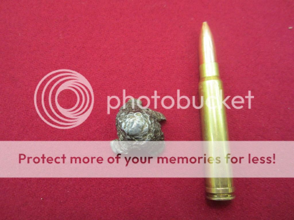

I haven't used Marshal's 30 cal on game yet but I have used his 270 gn 9.3 bullets and they worked excellent. I shot a grizzly at less than 30 mtrs and the bullet expanded larger than a toonie and retained 258 gns after washing. This was out of a wildcat driving the 270 at over 3000 fps. I just got some of Marshals 195 gn 30s but have not used them on anything yet.
I did use another of his bullets in my 23 cal last fall on a WT deer, the bullet went through and exited so not much to report other than it actually held together and went through...........105 gn bullet at over 3400 fps with a 1-8 twist barrel.......a bullets worst nightmare.....
270 gn spritzer RBT from my 9.3X300WM from grizzly at less than 30 mtrs.
If ever a bullet was going to fail, this should have been it...........heavy muscle and bone at point blank range with an impact velocity over 3000 fps.........Marshal's bullet came through with shining colors IMHO. It didn't just survive because it was such a large bullet to start with, it retained 96% of it's weight and shows no signs of jacket fracture at all, just beautiful petaled expansion. The lost weight was most likely core that scrubbed off during the "rocket ship" ride through the bear.
BOTTOM LINE...........I highly recommend Marshal's bullets to everyone and use them myself in all my hunting rifles !!!!!!!
