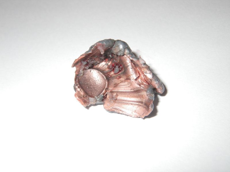

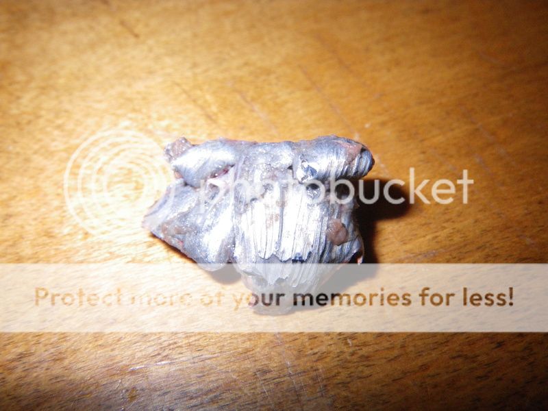

They're my favourite bullet in my 9.3x57. They're the most accurate I've tried out of 3 brands, they work well and it feels good to support a Canadian company.
Those are after going through a bull moose's neck and skull at about 100 yards. It started as 270gr and was 133.5 as pictured above.
Cory

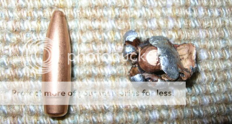

A single 270 gr Matrix was all it took to put this guy down for keeps at 60 yd.
Broke the near shoulder, two vertebrae, and ended up in the far shoulder.
You won't be disappointed with Matrix bullets. They are very accurate, even the hunting bullets shoot like match bullets, and as Cory says, Marshall is a great guy to deal with.
