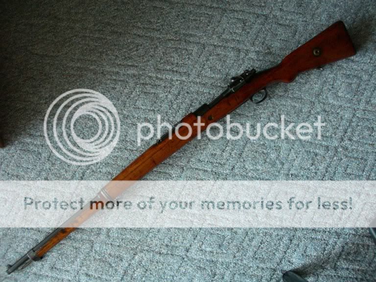

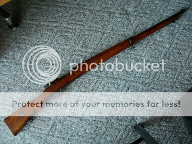

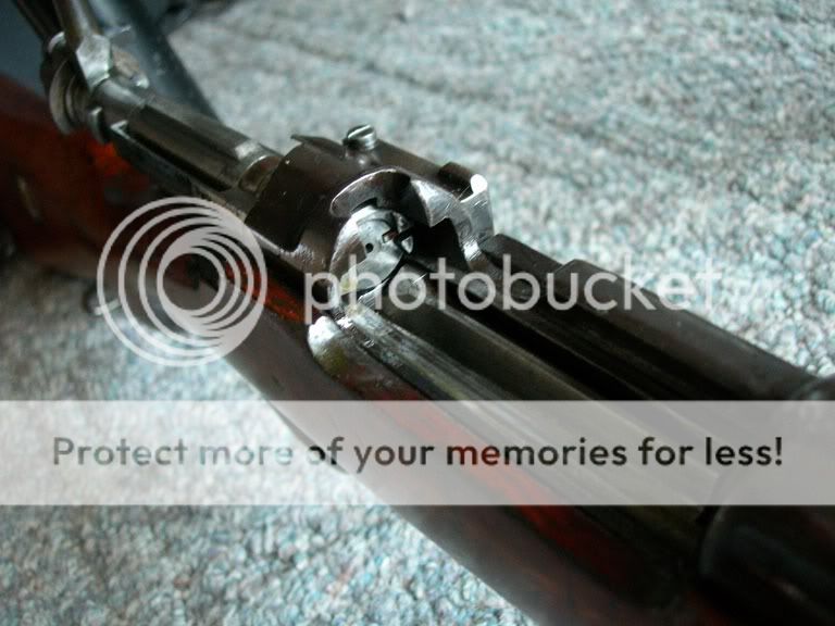

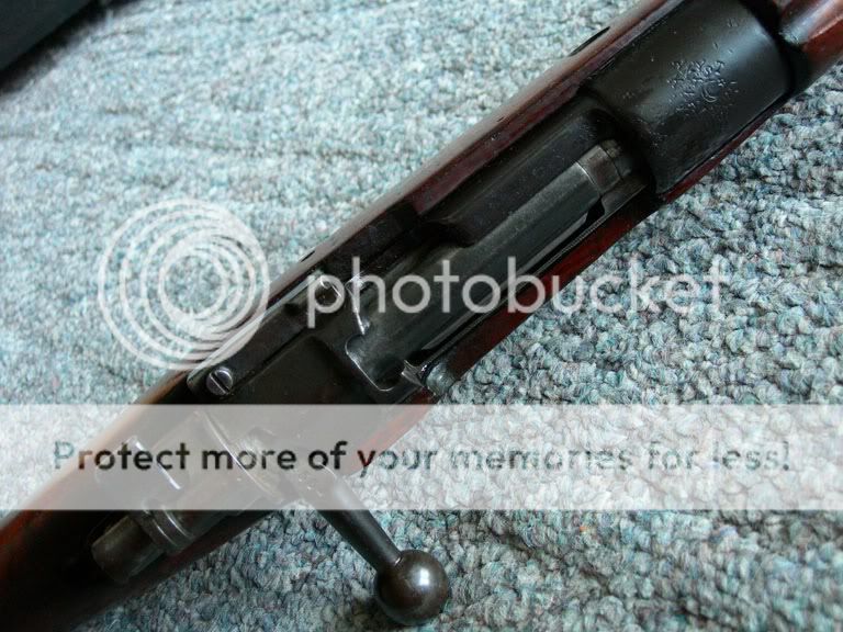

I'm new to reloading,only reloaded *my m1 Garand.I found a recipe that works great for my m1 now I'm looking for a recipe for my m38 1941 Turkish Mauser.So far I've shot surplus 8mm with no problems except a few misfires due to the hard primers(weak firing pin spring I assume)I recently acquired some Norma 8mm brass,I have primers and powder(imr4895,imr4064,imr4350)if any of you would like to help me with powder selection and bullet weight 150,175,200 grn? All advice would be greatly appreciated! All I'm going to do is plunk paper targets so I am leaning towards 150 or 175 grn fmjbt.
Thx again
Chris
PS a few pics of my girl....
