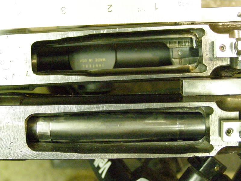

I've done what you are contemplating. Mine is a .375 Ruger on a FN 98 action that started as a .270 Win. There is a fair amount of action modifying required(rails, feed ramp, bolt face, extractor). Besides finding the right action, an even bigger challenge is to find a gunsmith that knows his way around a M98. Bill Leeper did mine but he's retired now.

This picture shows the amount of metal to be removed from the rails. Top is the .375 Ruger. Bottom is the .270 Win

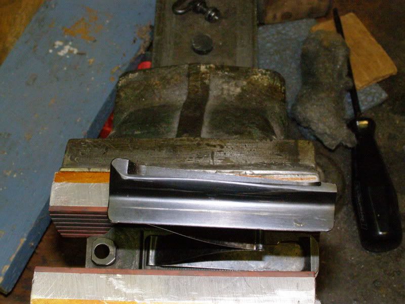

This shot shows a subtle mod to the follower. It helps the smooth feeding.
@Mauser98 did the stock come like that or did you sand of the checkering because it was buggered? So, the "bend" in the follower does help the feed?

Riversrest. I carved the stock from a blank. The follower mod makes feeding the last round smoother. I've tried a stock follower from another FN and there is definitely a difference in smoothness.
