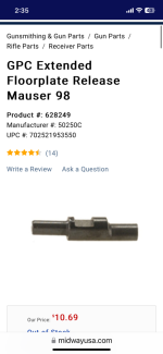

I am looking to find one of those for two of my rifles( husqvarna) if any of you have some in hand or know where one can find them please let me know!!
Or you could take your present piece to a good welder or someone who will silver solder an extension onto it, which you can shape to the length you desire.

Well, that sucks and yes I assume it could and can happen, that said I have the extended release on my 9.3x62 and never had an issue with it yet, plus I feel that pushing the pin in and moving the plate back to release still takes some “efforts” so I will take the chance!
It all depends on the "style" of the release and how easy it is to disconnect.
Rob gave a very good example of what "can happen" in worst case scenarios, but if care and attention are taken, shouldn't happen.

When you put this extension onto your rifle, make it just long enough to be practical and maybe even difficult to use.
If your rifle is a 98 "standard'' length, take a look at the magwells with swinging floorplates on Intersurplus. I put one of those on a build I did last summer, one of the engraved units. It looks good and works well, with the release being a stud inside the trigger guard. No fitting was required, it just slipped into place and its rock solid.
