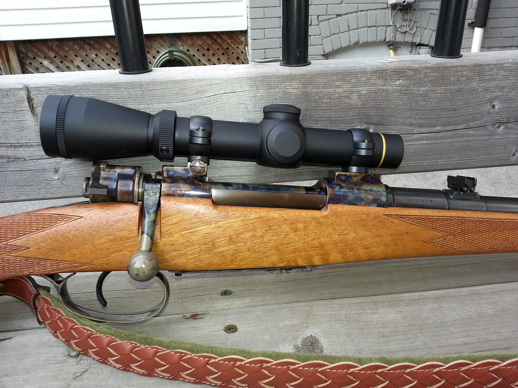

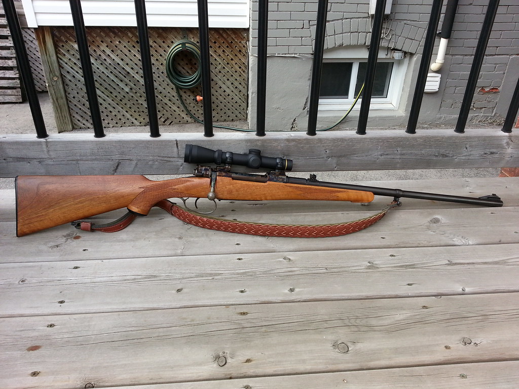

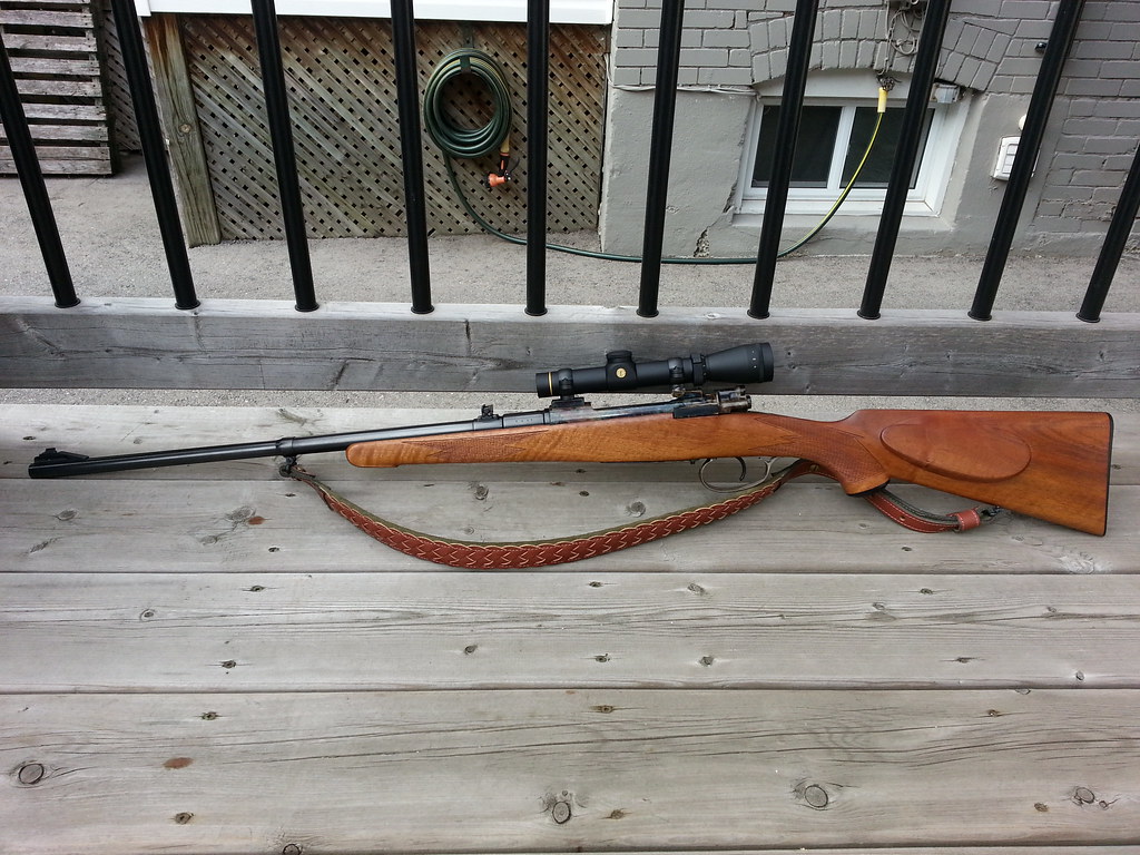

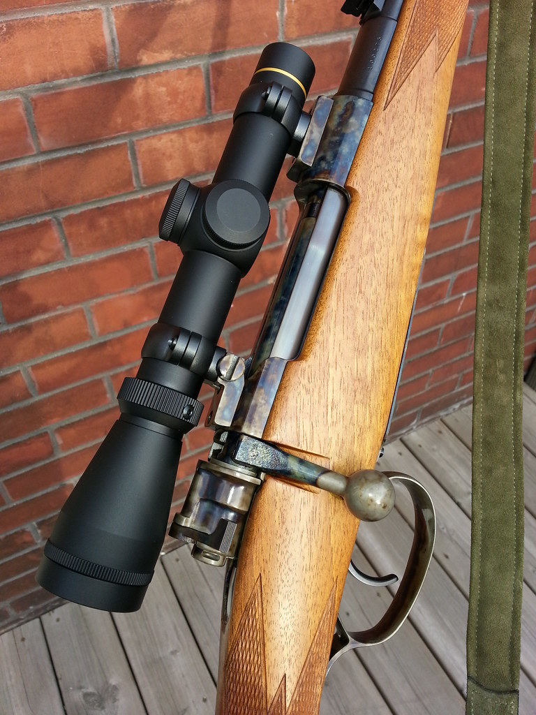

I run vintage Redfield bases. These give me the option of mounting low Leupold Standard rings (and also Burris). This option allows the scope to just clear the aftermarket safety/bolt shroud.
