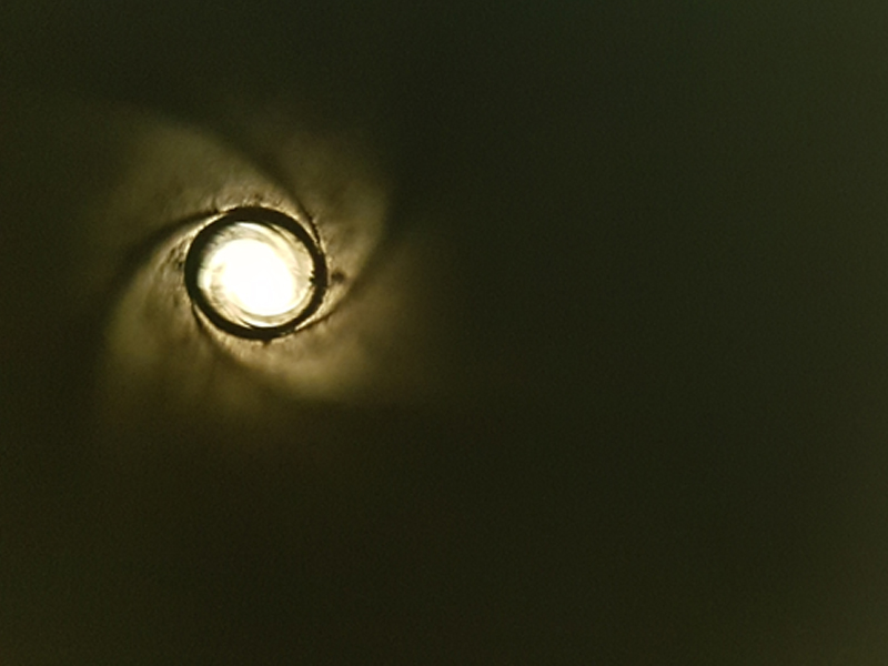

Took my new-to-me Mauser 98k to the range yesterday. Set up poster board at 25 yards to find where it was hitting and was sad to discover it was keyholing and putting up 8" groups at 25 yards. The barrel has a very small bulge about 3 inches from the muzzle which I knew about before I purchased it. Would this bulge be the entire cause of the keyholing, and if so, is there anything I can do about it? The previous owner told me about the bulge and that it didn't affect grouping, so I'm wondering perhaps he might have been shooting different ammo or something? I'm shooting the PPU 198gr ammo (and I bought the same projectiles) Other than than, the rifling is in good shape, crown looks good, and putting a bullet in the muzzle end it stops about 1/4" shy, so the projectiles are correct sized.
EDIT: I just re-read my e-mail correspondence with the seller, and I may have misinterpreted. The seller said "You saw the small ring inside? Rifle is shootable everything smooth" which I guess I interpreted "shootable" as "it still groups" but I guess I should have read it as "it won't blow up"
So back to my original question then, is there anything I can do? Different bullets make any difference?
