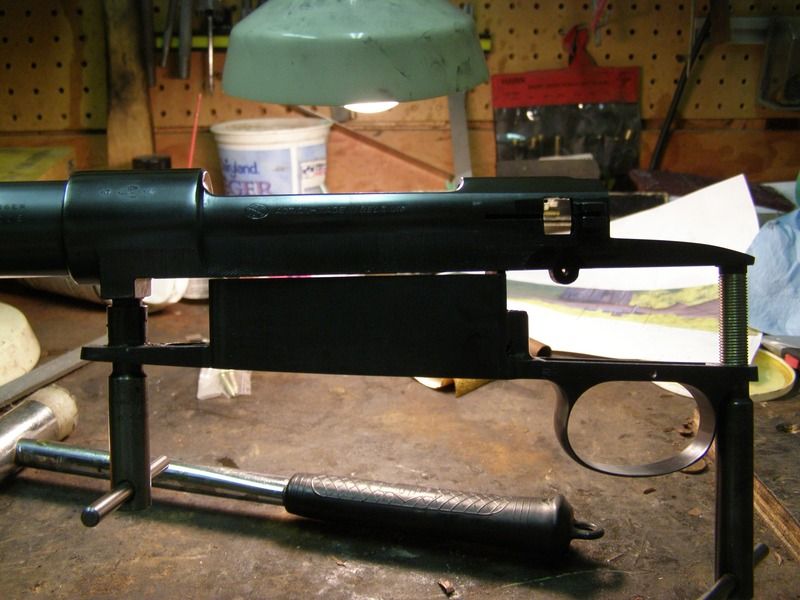

This is how I want my mags to fit in relation to the receiver(FN in this case). The rear pillar has been cut/filed to provide the clearance and the front pillar was already the proper length. I’ve done this on quite a few Mausers and have never found the front pillar to be a problem. In the OP’s case, perhaps a few swipes with a file to the top of the mag box would provide some clearance.
