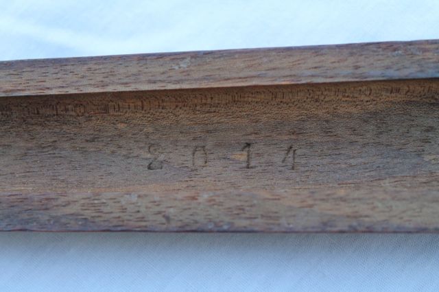

Well I picked this up off a good friend of mine (thanks Chris!) and thought I'd share some pics of it here because it isn't a Mauser you'll see too often. Condition isn't the greatest but a hard to find example so I was happy to add it to the collection.
Made by Mauser Oberndorf for export, the Model 1907 was bought by several countries in small numbers. Paraguay, China, Ecuador, and Brazil among others possibly bought small quantities of these. Production numbers aren't known and there is very little solid info on these at all. I haven't done a chamber cast on this one but the bore measures .284" and it chambers a 7x57 case so I would imagine that is the chambering.
The 1907 is commercial proofed which would eliminate a military contract and these were purchased basically "off the shelf" by the various countries as sort of trial rifles or to fill a temporary shortage. It is a large ring action with what appears to be a small ring barrel thread. Intermediate in length it shares several features with the Peruvian 1909 action and the Turk 1903. The front ring is longer than normal and has a lip machined into the front of it to hold the handguard similar to the Turkish 1903 action. It doesn't have the tall charger hump of the Peruvian or Turk action though but shares the long cocking piece and "pear" shaped bolt knob.
The bayonet lug and band arrangement is interesting and the same as the Model 1904. There is no metal recoil lug in the stock.
I suspect this one saw use in Paraguay because the bolt stop/ejector box and rear guard screw are marked with the 5 pointed star usually seen on Paraguay Mausers. These parts aren't original to the 1907 but have been with it for a long time. The barrel, receiver, trigger, rear sight, trigger guard, hand guard, and stock all match. The bolt is the correct commercial proofed bolt and is only a few numbers off.
If anyone has more info on these or an example to share please post it up.

I was hoping it was one of those but unfortunately the caliper just kept going past .277.
I love these old mausers. I doubt the star marked parts have anything to do with Paraguay. Some argentine parts are star marked and the brazilian crest has numerous 5 pointed stars on it.
In MMROTW, the star marked, paraguayan crested rifle does not seems standard, what are the screws for? And I don't see the same stars on the 1907 carbine on the facing Page. Plus it has British proofs, I'd bet it came out of turkey, that it was in the Mauser factory in 1914 and sent to the turks. But that is my speculation.
I would dearly love to own a paraguayan rifle, a souvenir of my visit there.
Well if you look on page 274 of MMROTW, you'll see the exact same star used as an inspectors mark on the 1907 at the top of the page. These little star inspector marks are unique to Paraguay contract rifles. I think the British proofs on the 1907 in the book were added at the time of import to England. I believe they require firearms to be proofed before they can be sold? Mine has no British proofs on it.
The star marked parts on my rifle could have been added any where and aren't definite proof of Paraguay usage. Many countries bought small runs of these 1907's and it could be from any one of them.
