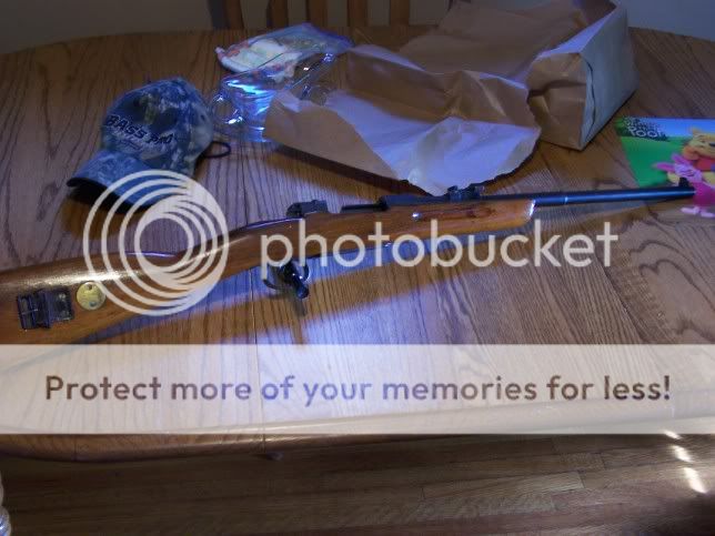

I inherited a Mauser rifle from my uncle. Had big plans to take a deer with it this year sort of as a tribute to my uncle. I took it in to the shop and they told me I cant fire it. I dont remember the numbers exactly but the bolt and serial number are about 700 numbers apart.
He told me that it may be ok to fire but I would need to have the headspace measured. If the headspace is too big then the only fix would be to find the right bolt for it, which would be like a needle in a haystack.
Is that right or can things be adjusted to make the bolt I have fit? I want it to be safe, so I dont mind doing things the right way, but seems to me there are so many of these guns around that the numbers cant possible match on all of them.
Heres a couple pics if it helps
That is a Swedish Model 94.

You need to go to a competent smith with the bolt and rifle. Tell us what part of the country your in and you'll get some recommendations from board members.
Your bolt may be intentionally mismatched and function within specifications for feeding and headspace. It was not uncommon for sporterized militaries to have their bolt replaced for a host of reasons.

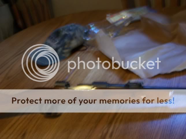

You should try your bolt for fit and function on an EMPTY chamber. Post a picture of the bolt here to see if it's correct for the rifle. Looks like a Swedish Mauser in 6.5x55...probably a very good deer gun.
I'm in Oshawa just outside Toronto. I will try and get some pics of the bolt. There is no forcing the bolt it fits in really nice. The guy told me that even if its a few 1/100th of a inch it could blow back a bit and maybe just pop the primer out of the shell but it may be worse. And he wouldnt know untill he measured the headspace.

That is a great little rifle! Hold on to it it will kill deer and moose until you pass it on to your nephew. And he can pass it on to his nephew. That rifle still has a half life of probabley 1000 years! Get it hunting
