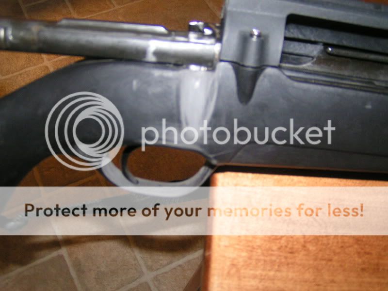

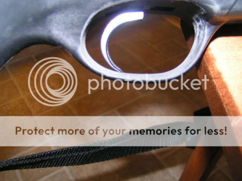

Well the trigger went on easier than I thought. I just used a small tipped screw driver and tapped it with a hamer and the pin almost shot out. I adjusted the trigger for LOP, travel stop, forward stop. I installed the receiver assembly into the stock and put it all together, I am using the ATI stock with integrated top scope rail. Well the trigger pul is short but dragged. I took a look and the trigger guard is thicker in the middle than the sides and the trigger was sitting on it. I took a piece of 220 grit sand paper, wraped that around a piece of copper plumbing pipe, and proceeded to flatten the inside of the trigger guard in the center. I have maybe a few sheets of paper thickness from the bottom of the trigger to the guard now and she functions just fine. Also in the pic you will notice a snaded area to clear the bent bolt. The bolt would not lock down which means the gun won't fire so I dremeled that to thin it out and then polished it up with 220 paper again. The gun is getting a texture coat of black once finished so I am not concerned about the mods. PICS!!!!!!
