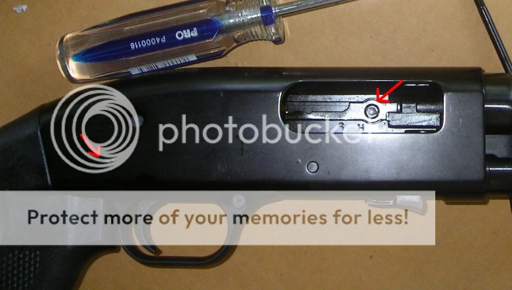

i noitced one thing weird... Check teh last pic.
Joel told me to take out the pin to see what happens. Nothing...
But then i noticed the lil hole on top is INDENTED! does that mean something?
Ahhh, now I get it! On the opposite side, the pin must be poking out!
Can you push it back in? So instead of being indented on one side it is flush on both sides?

No. That pin isnt poking out on the other side. One side looks good the other side looks indented inwards.
Sorry for the big pic guys, I have no way to edit right now...I think that pin is the problem. If it is indented too much it could be blocking the bolt as it moves rearward. Here is a pic of how it is supposed to look on the other side. Can you remove it and re-install it? The other pin, the one that is removed in your picture that holds the trigger assembly in place, can be reinstalled.

This happened to mine too.
I think this is the same thing that happened to me.
What looks like a pin directly above the trigger is actually not.
This is your problem if one side of this "pin" is indented and the other is not. Doesn't seem to make sense at first until you take the gun apart and find out that these "pins" are actually where the part numbered 19 ( in the diagram at the link) hook into the receiver to allow the feeding mechanism to pivot.
You must remove the barrel, remove the trigger group, and you may be able to wiggle this bar with the "half-pin" on the end to get the recessed "pin" back in the hole. If not, you must remove the bolt "carrier" and the bolt and reset the bars.
I'm not sure how it happened to mine either, but I suspect rough handling popped the pin out. This obviously pushes the bar in and jams the bolt and carrier from moving to the rear.
