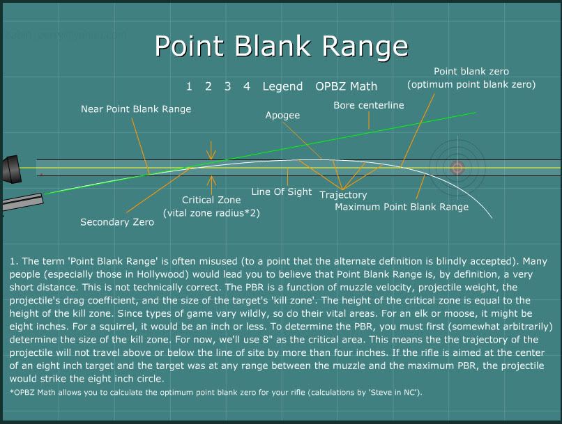

Point blank is the range where the bullet crosses a line, parallel to you sight line, that is the same distance below the sight line as the crest of the trajectory is above the line of sight.
Point blank range depends on the ballistics of the cartridge you are using as well as what distance you have zeroed your rifle.

That diagram is excellent Wally.
