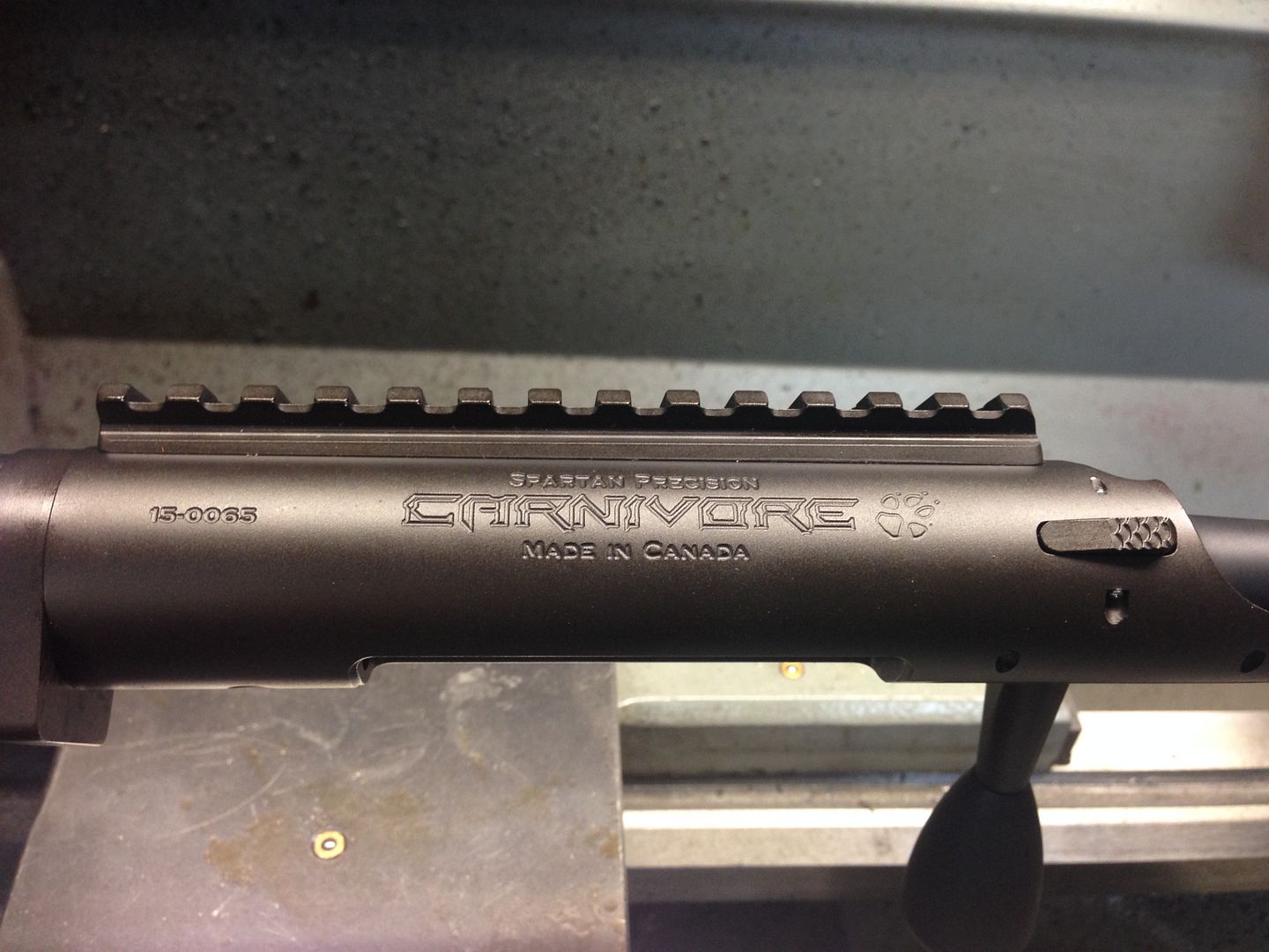

So, I had plans to replace the barrel in my R700 Police this fall. The round count is getting up there and I decided, with some prodding to re-do the rifle. Little did I know, I would be doing a whole new custom build. It started off with the venerable Remington 700 short action. I decided on a completely new action, which I picked up right here on the EE. The barrel was to be a Jury Custom in a Krieger style 17 heavy contour. Then came the decision...should I stick with the original oem stock from the 700 police. Well.....no. I decided on a Dolphin chassis. But problems ensued and I won't get into them here. Let's just say that the Dolphin was now out of the question. A recommendation from a friend (Shane with EMP Rifles) who just happens to be an MDT dealer, pointed me towards the HS3. Having just gotten a PGW Coyote, I dove right in thinking that they were pretty similar. (Let's not go there with the real world differences and just say that they are "similar".) I already had the glass. A brand new Nightforce nxs 5.5-22x56. The mount was to be by Richard Near with NEAR Manufacturing. The barrel was finished at 28 inches.
After assembling all of the parts, it was now up to Steve from EMP Rifles to work his magic. BTW, the rifle is chambered in .308. What you see below is the finished product which I got to try out today.
