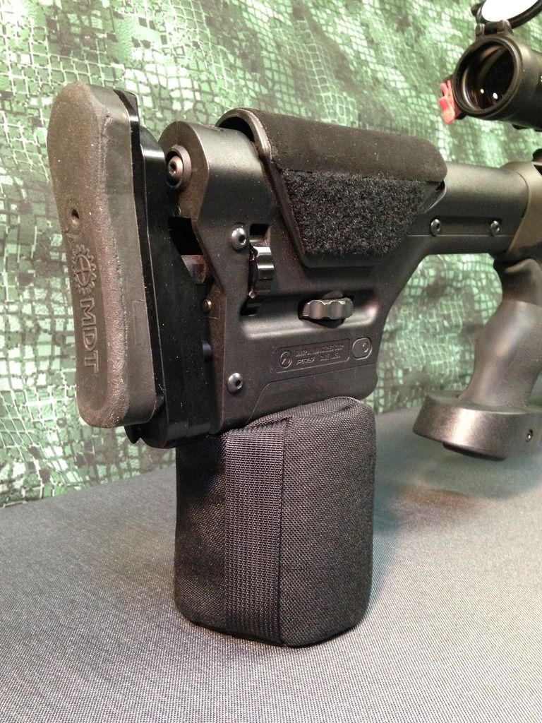

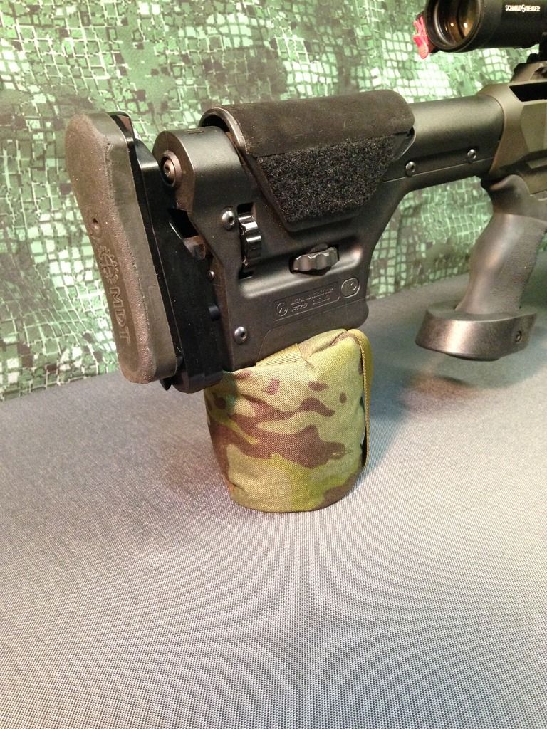

I can't comment on the CTR stocks, but I run a Magpul PRS with the MDT adjustable butt plate on my MDT TAC-21 that has a built in 20 MOA tapered top rail.
I use a S&B 5 - 25 X 56mm PM-II with 34mm high rings. I have the cheek rest raised 1/4".
On my rifle the minimum LOP is 10 5/8", and the maximum LOP is 11 3/4"

I measured from where the PRS joins the stock cap back to the end of the recoil pad. My PRS also has the optional MDT adjustable butt plate.
If you run a 56mm Obj. scope, you need the cut down MDT fore end. MDT milled off a section of rail to give more objective clearance.

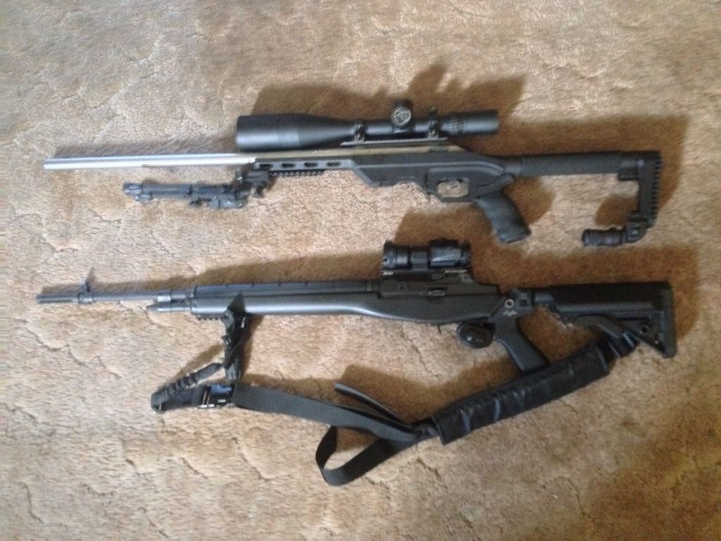

I don't find the riser necessary myself. The stock is from M14.ca and can be cut to whatever length you want. LOP is 13", it was cut when I got it so unsure as to how long it could be.
