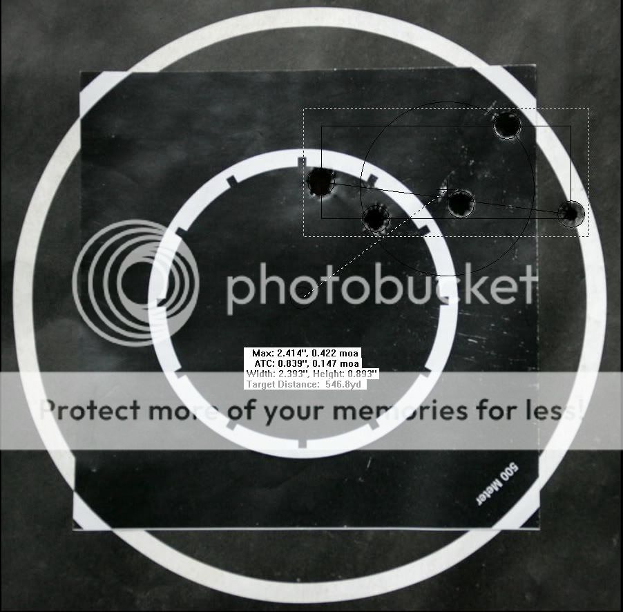

Try this if you want to be accurate... http://www.ontargetshooting.com/index.html Just take a picture of your group with a ruler held against the target.
