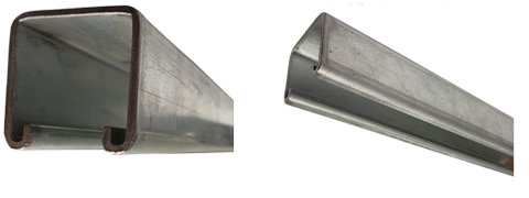

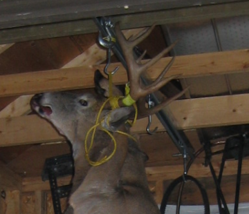

I use C Channel rail and trolley I got from Rona 15 years ago (Rona now own by Lowes). Don't know if they still carry it but you can get the parts off Amazon.
The rail is only 8 feet long but you can butt it together to make it longer. I drill holes and lag bolt it to the rafters. I use hook bolts instead of the eye bolts. Sister the rafters if they are only 2x6 or else they can split if you have more than 1 deer or moose hanging.
Here is what the parts looks like. The installed unit is supporting a 180 lb buck dressed (11 points). You can't see it in the picture but I have a rope hoist higher up to pull the deer up than transfer it to the hook trolley. Dead lift 180 lb over your head is kind of difficult especially when you are over 50 yrs old.
I am currently using the same system these are Unistrut and think couple other Companies making compatible track / railing under different name but with same dimensions.
I used those tracks along with a single row bearing (not the dual row as posted here) in my converted beverage fridge to hang an entire deer for dry aging without any issue.
They are very strong and sturdy setup and relatively inexpensive just Google Unistrut.
