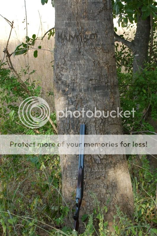

Doug's .470 in full song
John Wilkes .500 NE
When I was shooting Doug's rifle, I found the recoil about as I remembered the .500 Nitro, so perhaps the Merkle is a bit lighter than the John Wikes .500 I used in Tanzania; the .500 shoots a 580 gr bullet at the same velocity as the .470 shoots a 500, so in equal rifles should kick harder. The cases have the same length and head size, but the .470 is necked down; without looking it up I'm not sure how this affects powder capacity. IIRC, the .500 was loaded with 89 grs of 3031 under a 580 gr X bullet for 2150 fps. I don't recall Doug's .470 load, but I would put it in the same class as my .458. Frequently the .500 tied up and was difficult (for me) to break, this didn't happen with the .470. Because I'm more familiar with bolt guns, and not much of a double fancier myself, I have a greater comfort level with my M-70. I had trouble with the front trigger, which is no fault of the rifle, its me, as the same issue arose with the .500, I dislike not having the trigger in the same position with the same feel for each shot. I did find that the .470's barrels heated quickly, and that if long strings are fired, a gloved hand is beneficial.
