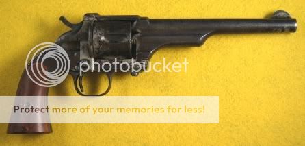

This is my MH .44, but the dealer's photo. Can't afford one with a lot of bling, and would just make my other brown guns feel bad. This one will have to do. Seller says should be a better shooter than a looker.

This old gal is the first batch of the third model. Top strap, but still the scoop flute cyl. All numbers match, they were just using up the second model parts. Making this a Transition model single action. I hear a couple hundred came out like this. The grips are marked too, but are left-over second models also. ???
