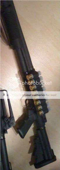

i have a Mesa 8 rounder as part of the low adapter kit on my Mossberg 590. My other Mossbergs have the Tact Star and they have been just fine .. I was looking at the aluminum Mesa receiver mount six shot carriers - but it seems that they may not be worth the money ....
The only advantage I see is that the Mesa carriers allow for the S/N to be visible on the Mossberg shotguns ...
