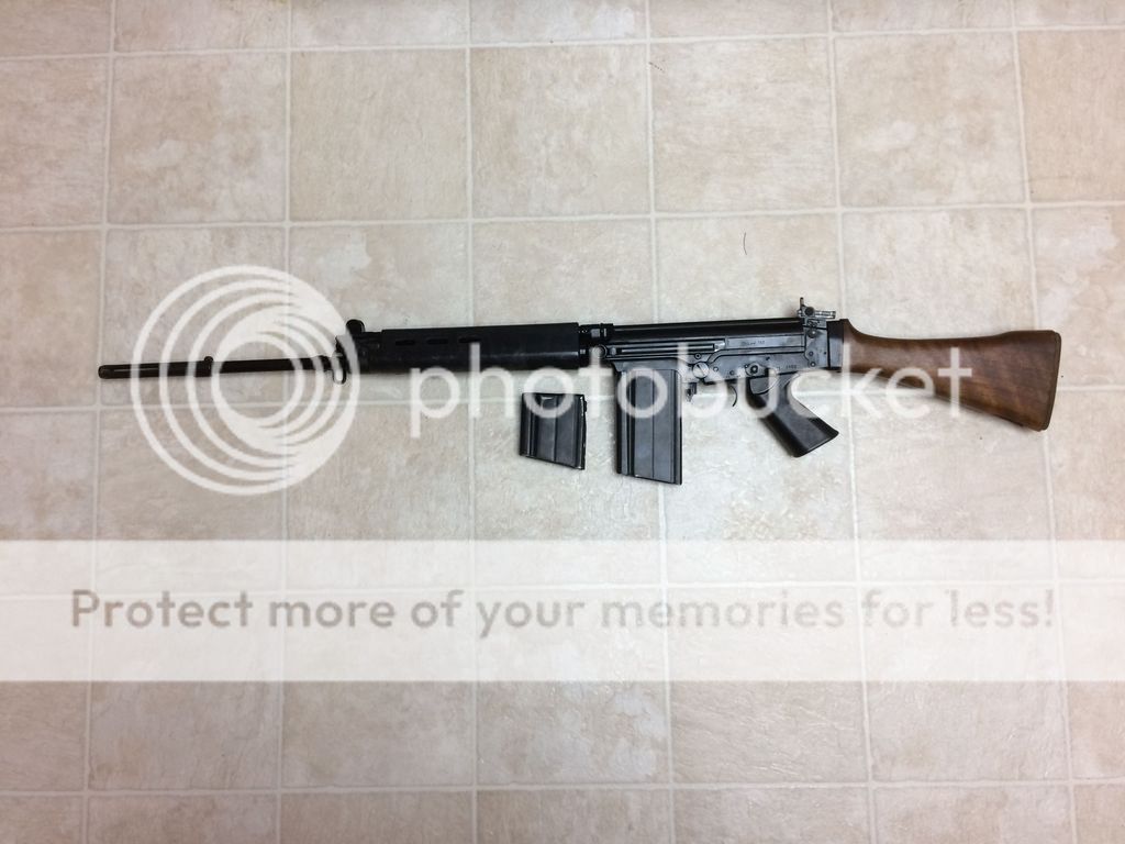

1) Strange configuration… wood stock, fibreglass handguards and a plastic pistol grip… would this be ‘normal’ …or signs of a ‘Frankenfal’ ?

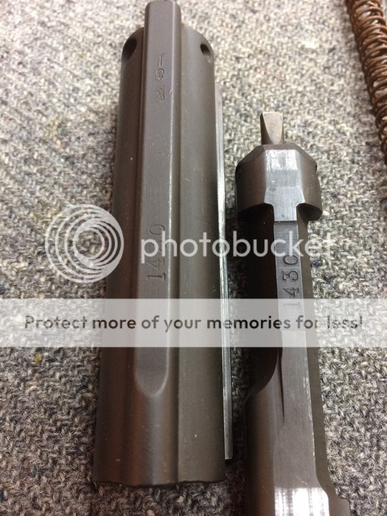

2) All numbers match, though… so I know it cannot be just a slapped together ‘Parts’ gun….

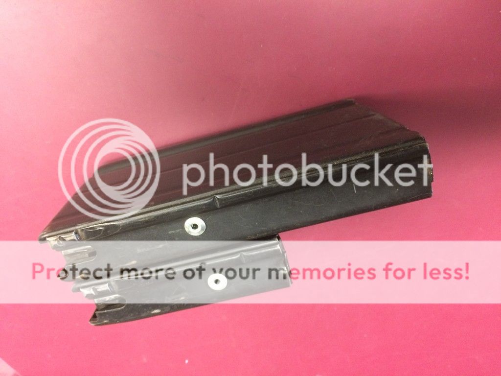

5) Came with the good old standard 20 rounder, but strangely also came with a 10 round mag, which is identical to the 20 in fit, finish, looks, etc, etc. The dude swears the rifle came with both mags… so, since when has any military FN ever had a 10 round magazine issued with it ??? ( I’ve seen a few 5 round, but they were built from cut-down military mags…)

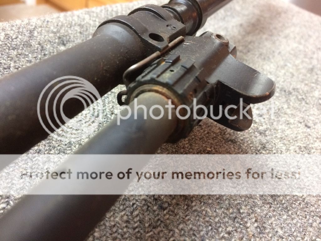

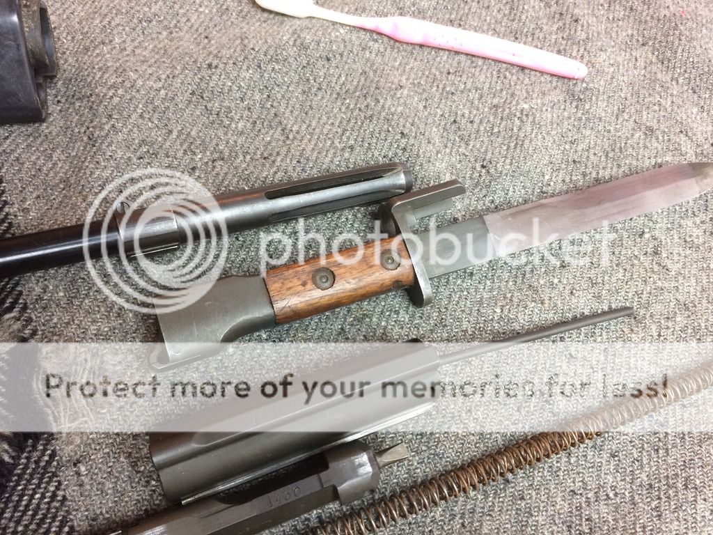

6) I am pretty sure this is a Metric FAL bayonet… but does not fit in the least. The flashhider is way too big, and the ‘latch’ would never fit in any case… just look at it.

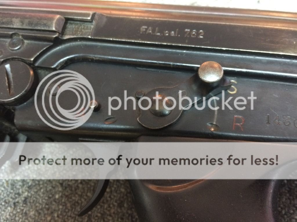

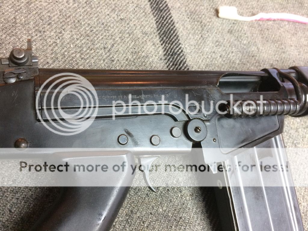

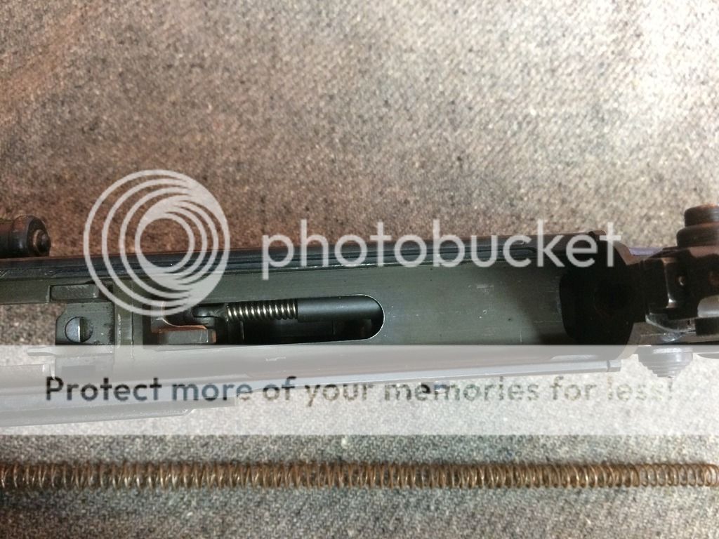

7) Last but not least… a very interesting discovery when I picked her up. I had done the entire deal over the phone with the guy, the RCMP, Mirimichi and the SQ … let’s face it… for that price I just bought it sight unseen. RCMP and SQ both confirmed it was a legit 12(5) FN and no problem transferring it… he was 12(5) and I am 12(5) so no problem. This looks to me like a FA receiver… but factory-built as a SA. What gives? Did FN do this on a regular basis? Factory pinned, and no cosmetic signs of ever being switched over to the ‘A’ position… also… dead giveaway is there are no FA parts in her… and no cutouts for them either. Soooooo… what gives?

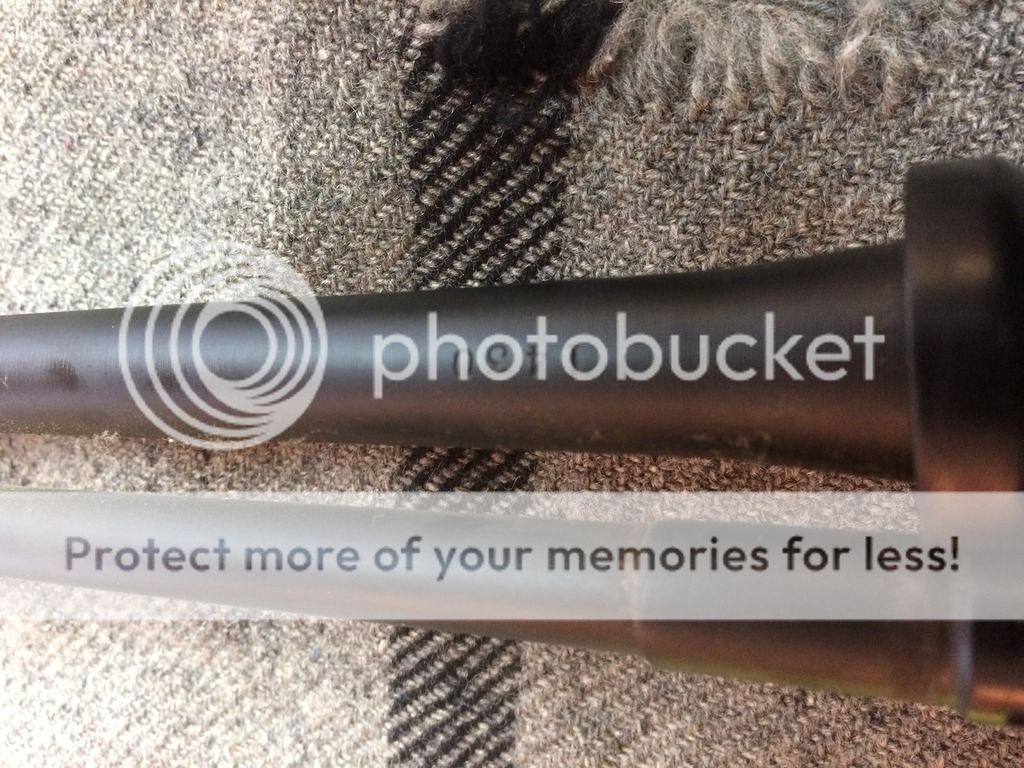

8) What, then, pray tell is the model of my new rifle? Military? Civilian? Any idea as to what country it was built for? Why is the flash hider parkerized, but the rest of the rifle, both mags included, look like it is Suncorite over Park…just like a British rifle … but definitely a Metric FAL.

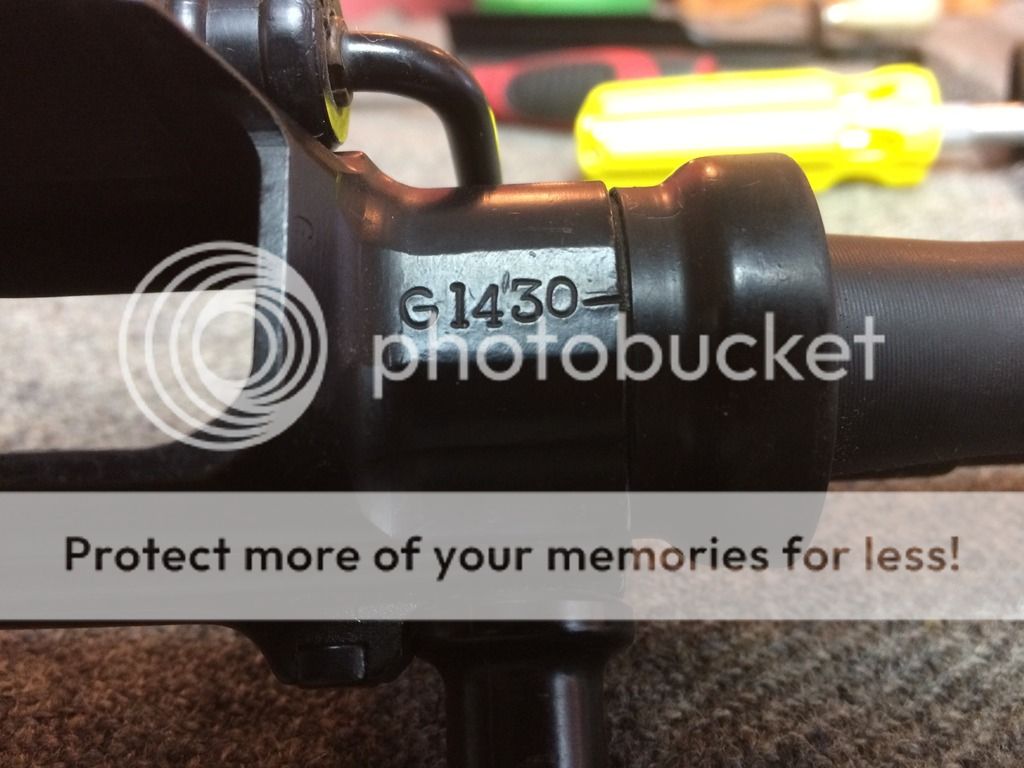

Its a G series FN FAL sold years ago for civilian shooters its a 12-5 class firearm. Check out older SIR books from the 80s.
The G series is one of the few FNs that isn't considered a 12-2 or 12-3 class firearm.
I have the same exact one and the serial number is only 44 away from your gun.
I have minty FN FAL that I bought in January 2014 that just got back from Ottawa to Epps for a couple of mods before its released to me.
The G series is also one of the few FN FALs that got into the US before they clamped down on them. The US serial numbers can be found in the Collector Grade Publications book on FNs by Blake Stevens.

Looks like your basic "Sporter" configuration. Have the identical rifle, right down to the serial number range. Think these were imported by Browning in the dim past when rifles like this weren't considered tools of the devil. Should be no safety sear cut out, to make it incapable of full auto fire. Mine came with an instruction manual, complete with Browning log. New price, if I recall correctly was around two grand.
Grizz
You did very well, you have one of the best FN FAL rifles, very similar to my own personel Portuguese model except mine has no flash hider. If I remember correctly your mix of furniture is original.
The bayonet you show would be correct for a rifle like mine that has no flash hider, the two prongs on your bayonet make the flash hider when attached.

That's how FN built them. Both military and civilian metric lower receivers typically have that same pin. The idea is that select-fire rifles (with an auto sear) could be easily limited to semi-only with the substitution of the "R" selector switch, as your rifle has. Given that automatic fire out of a full-power rifle is basically useless, many armies had their FALs so configured. Civilian rifles use the same semi-only selector, but cannot accept an auto sear.

Looks to me like it has the slot for the safety sear, only difference between a semi and full auto version.
Grizz
The ejector block does appear to be cut for an auto sear. The receiver would also have to be machined in order for the rifle to accept an auto sear.
