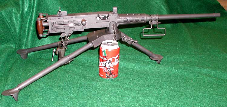

Here's a pic:
It has since seen a cold blue (steel wool and another blue coat to follow shortly) as well as some detail work, but the feed system is the only holdup now.
It's been testfired single-shot, and it works.
It will not (unfortunately) be a belt-fed system, I'm looking at magazine feed, probably a Ruger Mk II system.

Just wait 'til I get my M2 up and running....
It's down to a feed issue now.
Here's a pic:
NS
What caliber is that M2 ? .22 lr (Ruger MkII magazines) ???
Comparing the size of it with the coffee cup, I estimate this MG to be at least 1/4 size of the "real" .50 cal M2.
Who manufactures that thing ?
